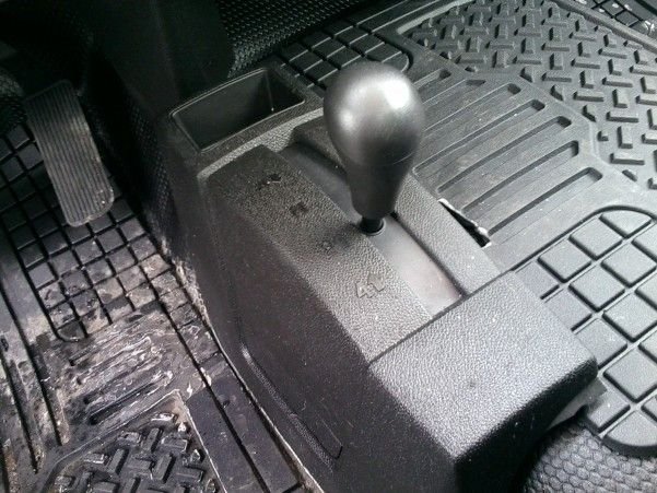

Well, I am amiss. I thought a manual TC would have a lever, not push buttons, I do think your TC is a MP1222. It should have a manual lever on the floor, not on the dash, but it may have indicator lights on the dash. Have you looked t see if it has an actuator motor on the TC?. This is a pic of what it should look like, if it's a true manual-shift transfer case.:
If not, you could have a blown fuse, or an actuator motor that has gone bad. You also might want to drain the TC fluid
and see what some out or run a flexible magnet down the fill hole, if not. Might be an internal issue in the transfer case.
Old Jan 16, 2021 | 7:50 AM
Scott Clements's Avatar
Joined: Jan 2021
From: Halifax, NS
That is the Shifter we have on the truck. The lights I am refering to are on the dash display when placed into 4x4 either high or low to indicate it is activated. Also when placed into 4lo usually it trigers the traction control to the off position indicated by a light on the dash as well.
