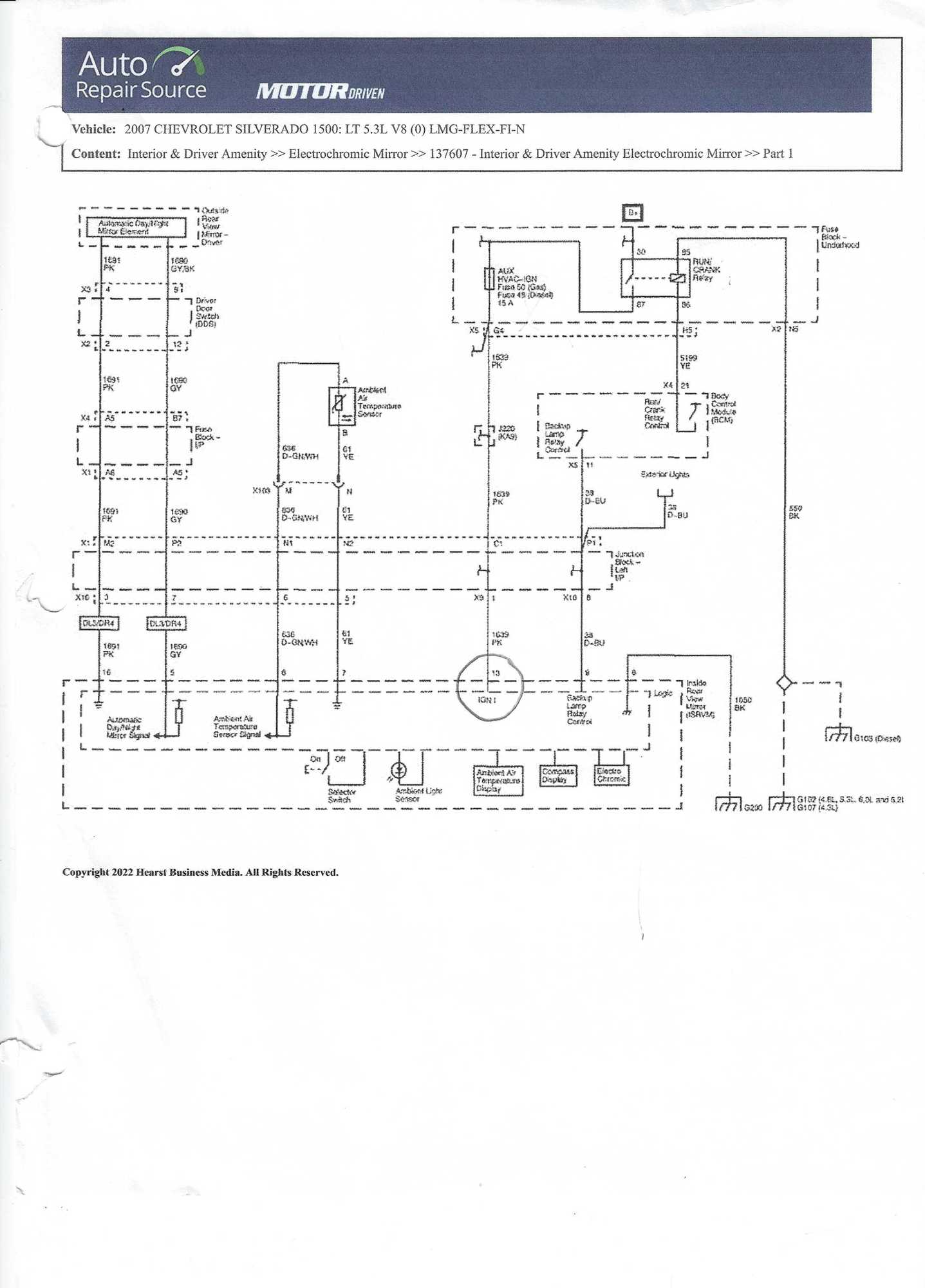

the compass and outside temp usually were located in the rearview mrror.if the plug is under the headliner then your good to go,if not then you will have io get a wiring diagram from all data and wire it up yourself....not impossible just labor intensive

So, my rear view mirror contains the backup camera image in the left ⅓ of the mirror. I would not be averse to relocating this image to an aftermarket screen.
My mirror does not have the small square space on the right side which usually is the place where temp and heading are displayed. When I replace my mirror with one that does have that small square in the right quadrant, nothing is displayed in it, and the backup image is not present.
Also, my instrument dashboard does not have the space where the temp/heading is sometimes displayed.

i installed a rearview mirror from a silverado into my 08 express van.i got the silverado schematics from all datat and ran the wires accordingly.two wires from the outside air sensor straight to the mirror and then power and ground and everything worked.now in your case your need to see what wires are present and what wires you need to add.also check fuses.
