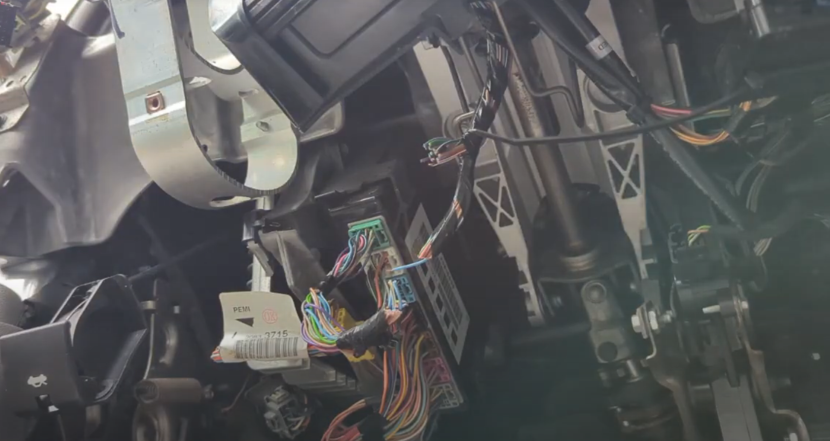

it should be sitting right beside the steering column. it will be vertical so youll only see the profile of it
this isnt one of out trucks but its a chevy and its about the same area
