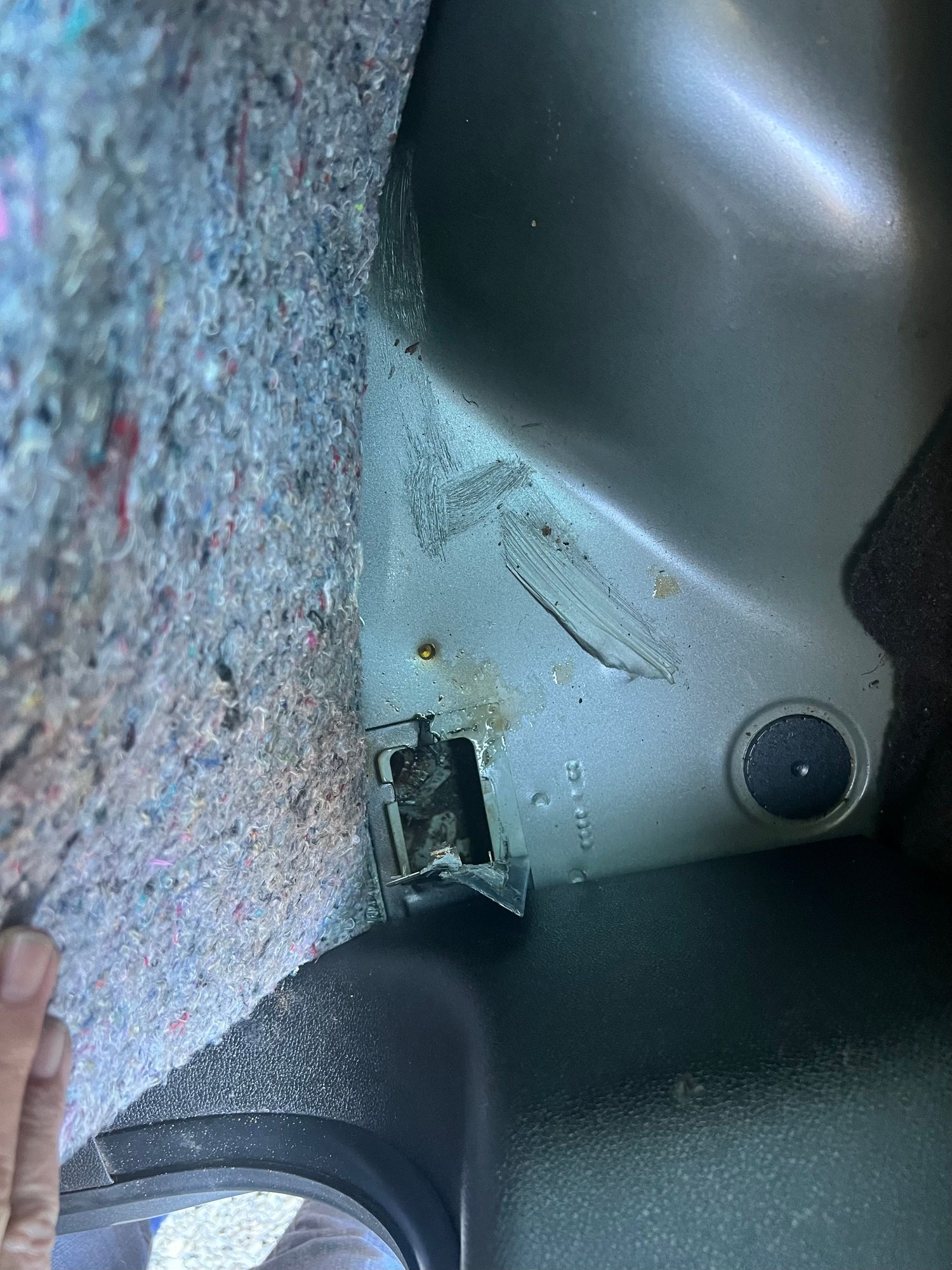

Is there a plate on the floor to access the rear cab bolts on a 2013 Silverado 3500 dually? Was going to put nerf bars on and the back bolts is just spinning.

Found the access plate. Behind the seat and under the flooring.
