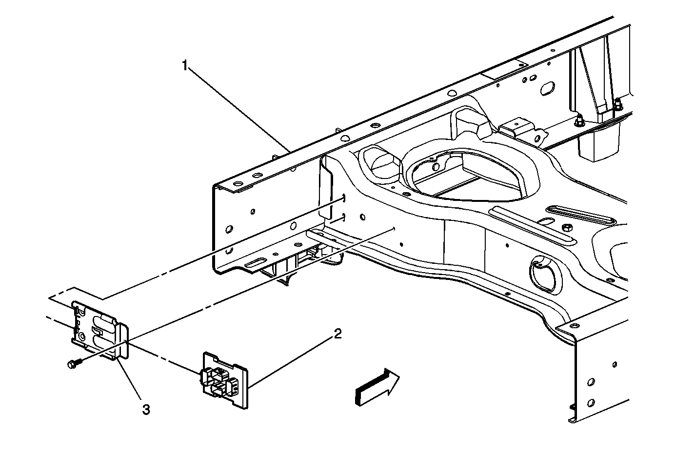

4) There is a junction block for the rear lights on the frame rail near the spare tire (see illustration below). They are known for having corrosion problems - it’s possible a short in this junction block is causing feed back to the front. Remove all the connectors and inspect for corrosion - it’s much easier to do if you have an air compressor for cleaning the crud out. Dirt gets packed into the release tabs and makes it difficult to remove them. You don’t have to drop the spare to see it but it will give you some more working room.
#2 is junction block

Ok I went through the list of stuff you recommended nothing changed when I pulled all of the fuses in the cab and under the hood just the driver side turned off and i checked the junction box in the back and aside from the dirt on the outside of plugs there was no signs of corrosion and the same goes for the fuse block in /out all 3 look to be in good condition

If nothing I suggested made a difference, the location of the problem can be narrowed down by working from the rear junction block and lights, even if the short turns out to be ahead of the junction block. I understand the harnesses may look good externally, but that doesn’t mean there’s no damaged wiring inside them.
