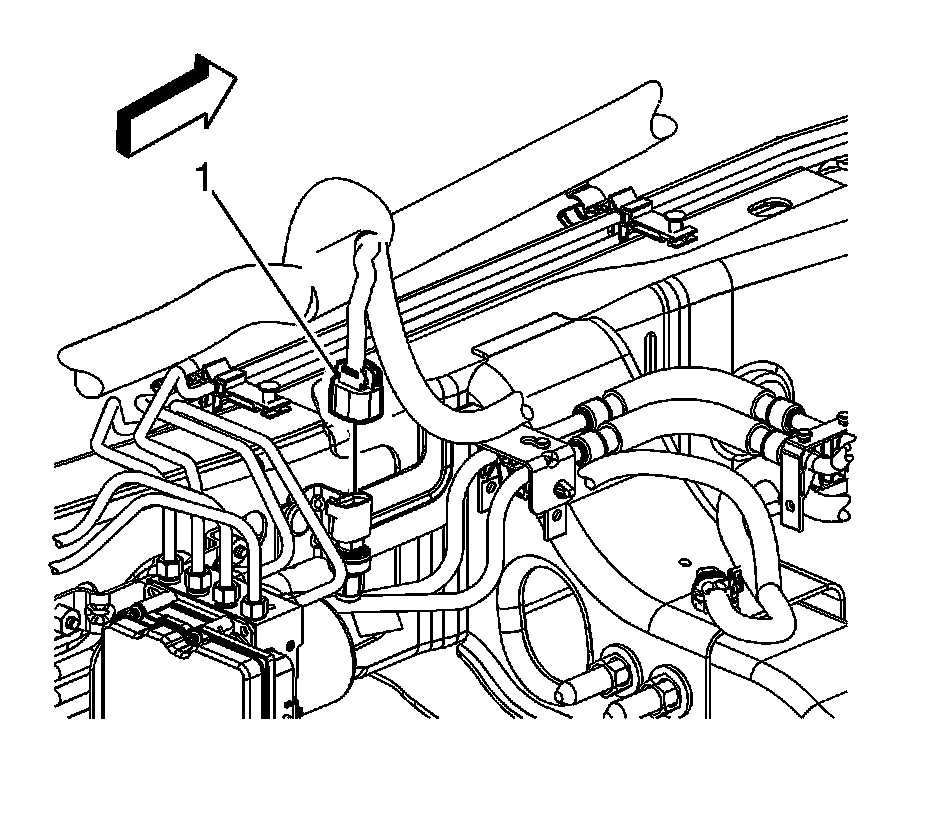

Getting this code on my 2007 silverado 5.3v8
fuel rail pressure sensor circute range/performance.
I've watched several you tube videos on changing the sensor sensorengine & make of truck, but they all show the sensor as being located on the fuel rail. I dont see any sensors at all on either of my fuel rails. Has anyone ran into this? Is it mounted in a different location?

The only fuel pressure sensor I see in the repair manual for a 2007 Silverado 5.3 (assuming NOT the 2007 "Classic" appears to be located on the firewall, inline in the fuel lines from the tank. Here's a diagram in the manual for the truck:
https://charm.li/Chevy%20Truck/2007/...0and%20Repair/
A 2007 "Classic" (GMT800 instead of GMT900) does not appear to have this sensor at all. And I will bet that the videos you've watched on Youtube are for newer vehicles than the GMT900 or GMT800.

I'd say that was it, found it on the frame even with the drivers door. Thanks for the help
