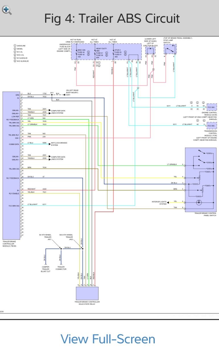

Here’s a wiring diagram.
Most common issues are damaged wiring at the rear bumper & poor connections at the brake relay, the control module, and the plug.
This is captioned as the trailer ABS circuit but the wiring/operation is the same as normal brake operation.

the connections and wiring that is easy to access all look good and I replaced the in dash controller but still have the issue. I have the frame mounted trailer brake controller module ordered so I’ll change that and see what happens. If nothing changes I’ll start chasing wires using that diagram
I did change the frame mounted controller and still the same so I’m not sure what to do next other than start chasing wires
