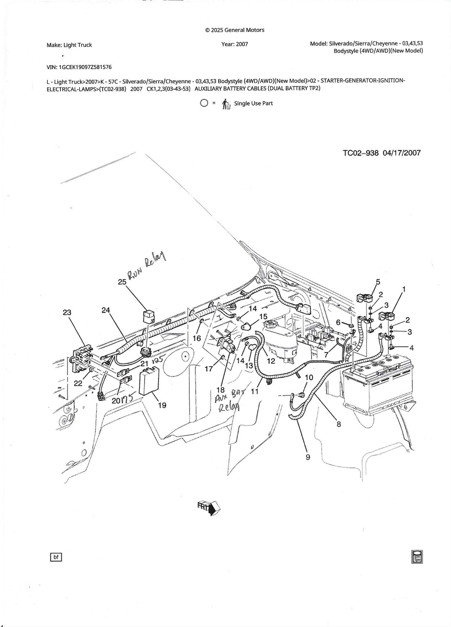

anyone out there have the factory installed option,with all the factory parts?ive recently aquired all the parts but theres one part that doesnt make sense?

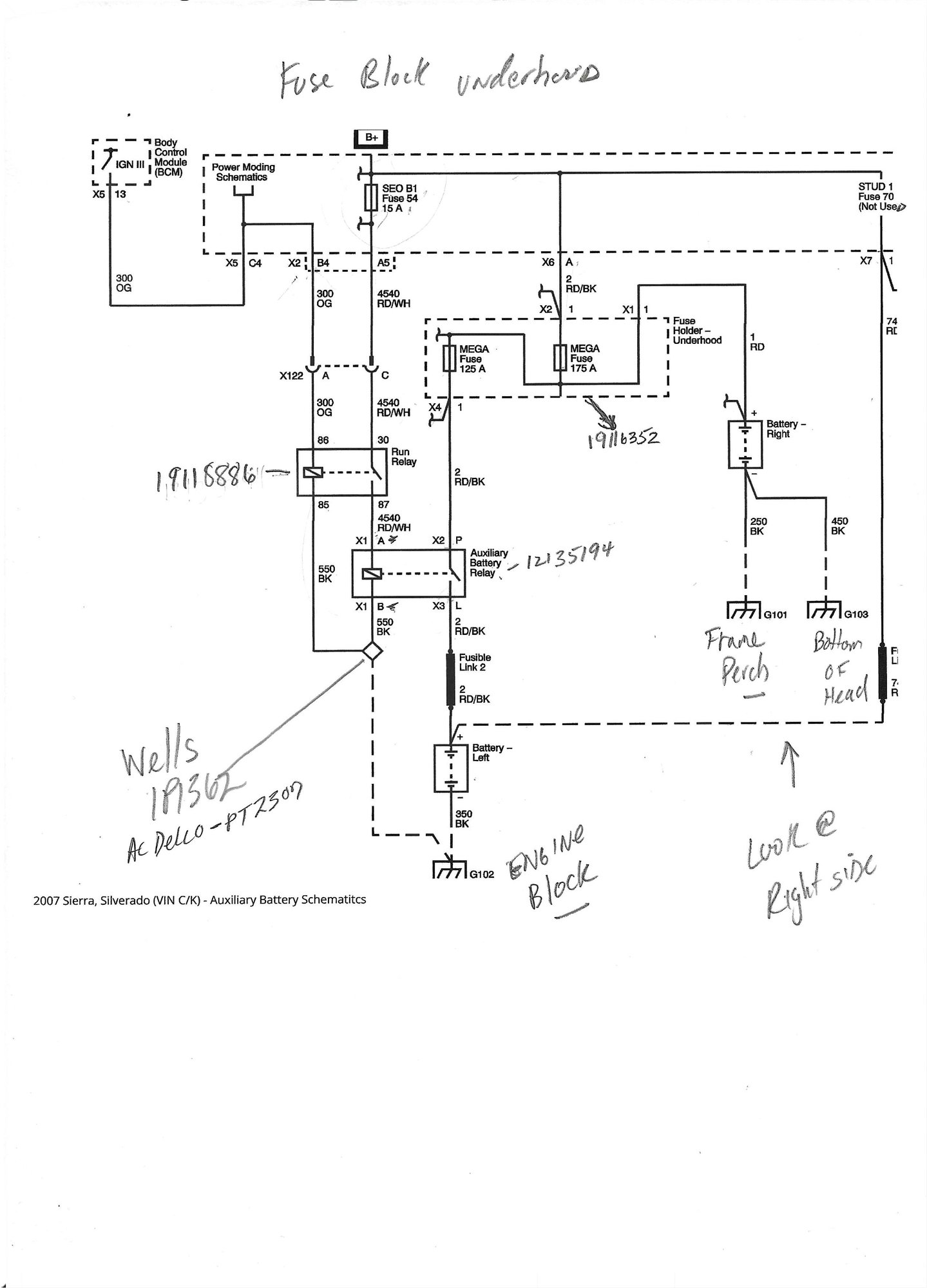

so if you look...that little plug between 20 and 22 is connection x122...in the wiring diagram.it shows a pigtail connection going back to the underhood fuse panel.this is the part i dont understand
