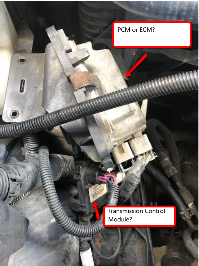

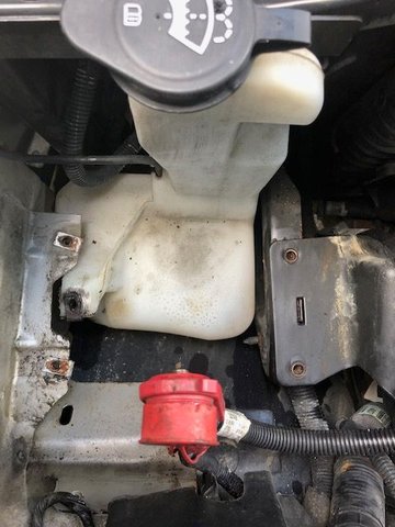

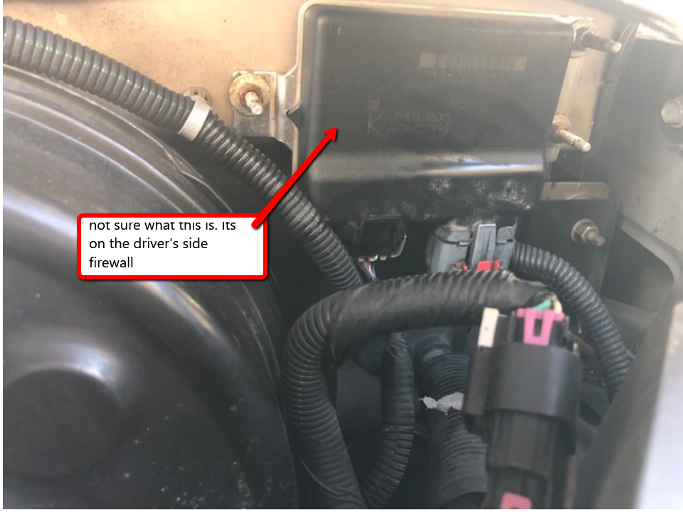

I removed the battery over the weekend but I'm not seeing any kind of module below the battery tray.
Please see attached photos to help me determine which is the Transmission Control Module.
Appreciate the help,
RickR90s
Old Jun 29, 2020 | 2:35 PM
try punching the numbers on the modules into Google.
