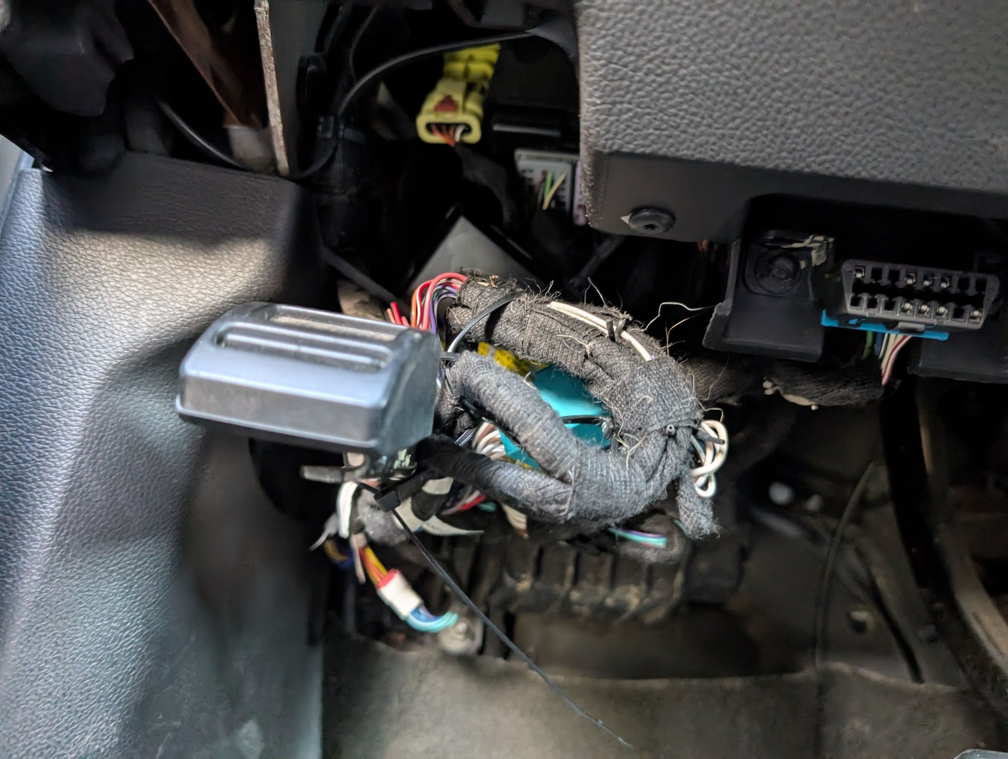

I accidentally found out that my "Viper" remote start was the culprit. I went through all the same Service Errors and decided to reconnect my remote start. Ta-da! The remote start was sending an error and a code for the TCM would pop-up. I cleared it out and fixed my remote start and haven't had any issues since. This saved me about $2000. I hope this helps..... Also, my Viper wiring is located right next to the code reader connection... Just FYI.
