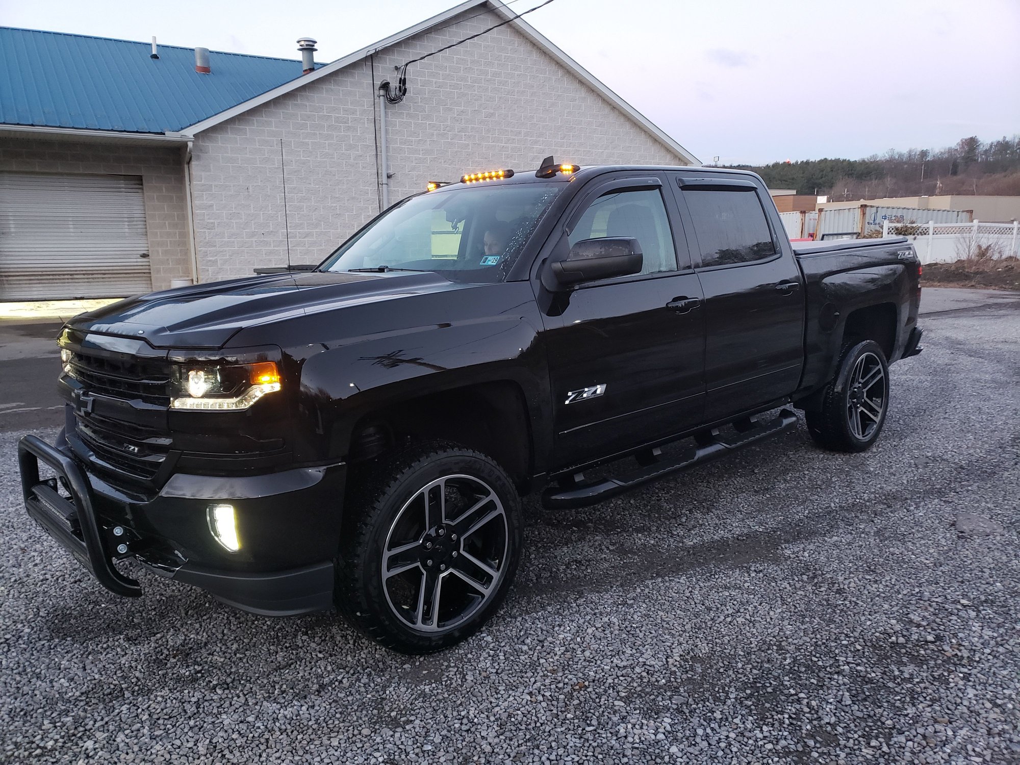

Im new to the forum and just saw your post from earlier in the year, i have a yotomoto (name maybe wrong) but i have a 3in front 2in rear level with a diff drop , after front end alignment ive had zero issues and ride quality is factory, mine is on a 17 z71 crewcab
