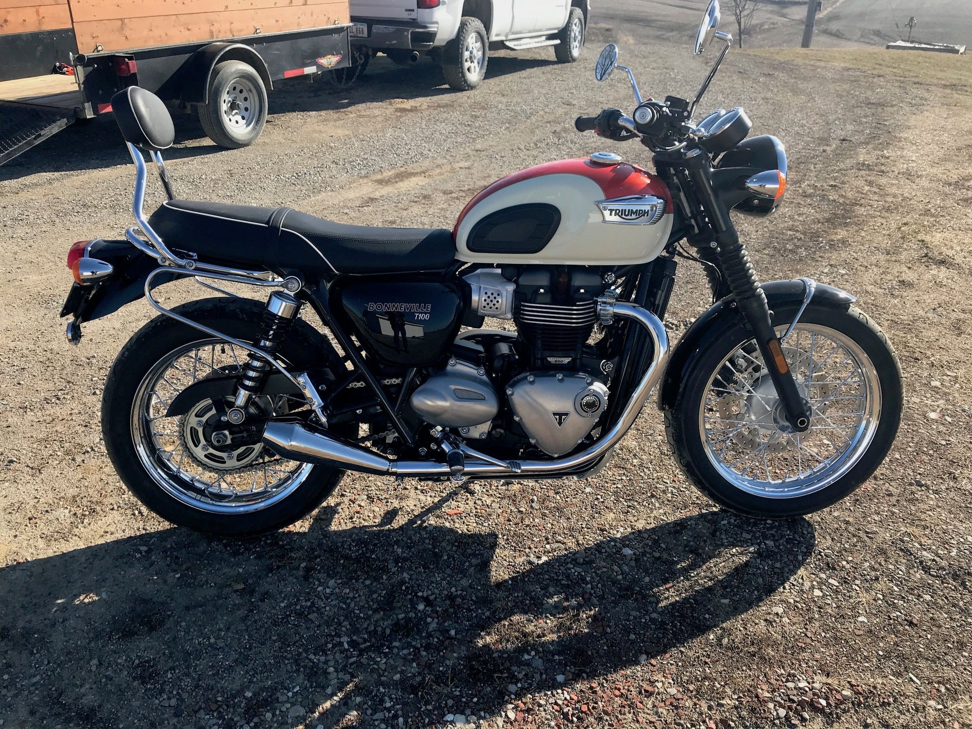

Bikes are getting heftier all the time. My Triumph Bonneville weighs roughly 500 lb. And it sure isn't a heavy duty cruiser. Just a basic naked 900cc bike. The big road bikes easily top 1000 lb.
