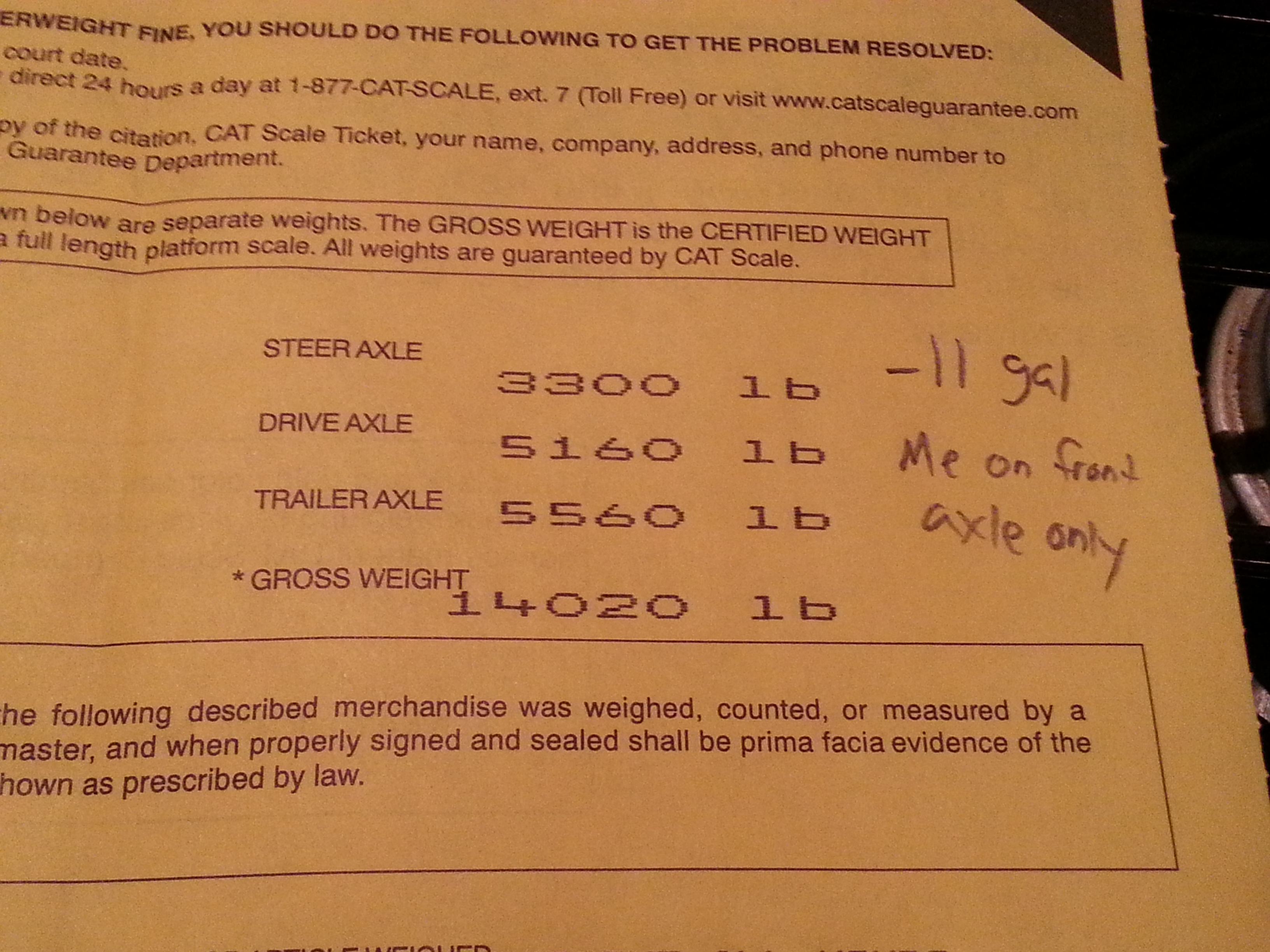

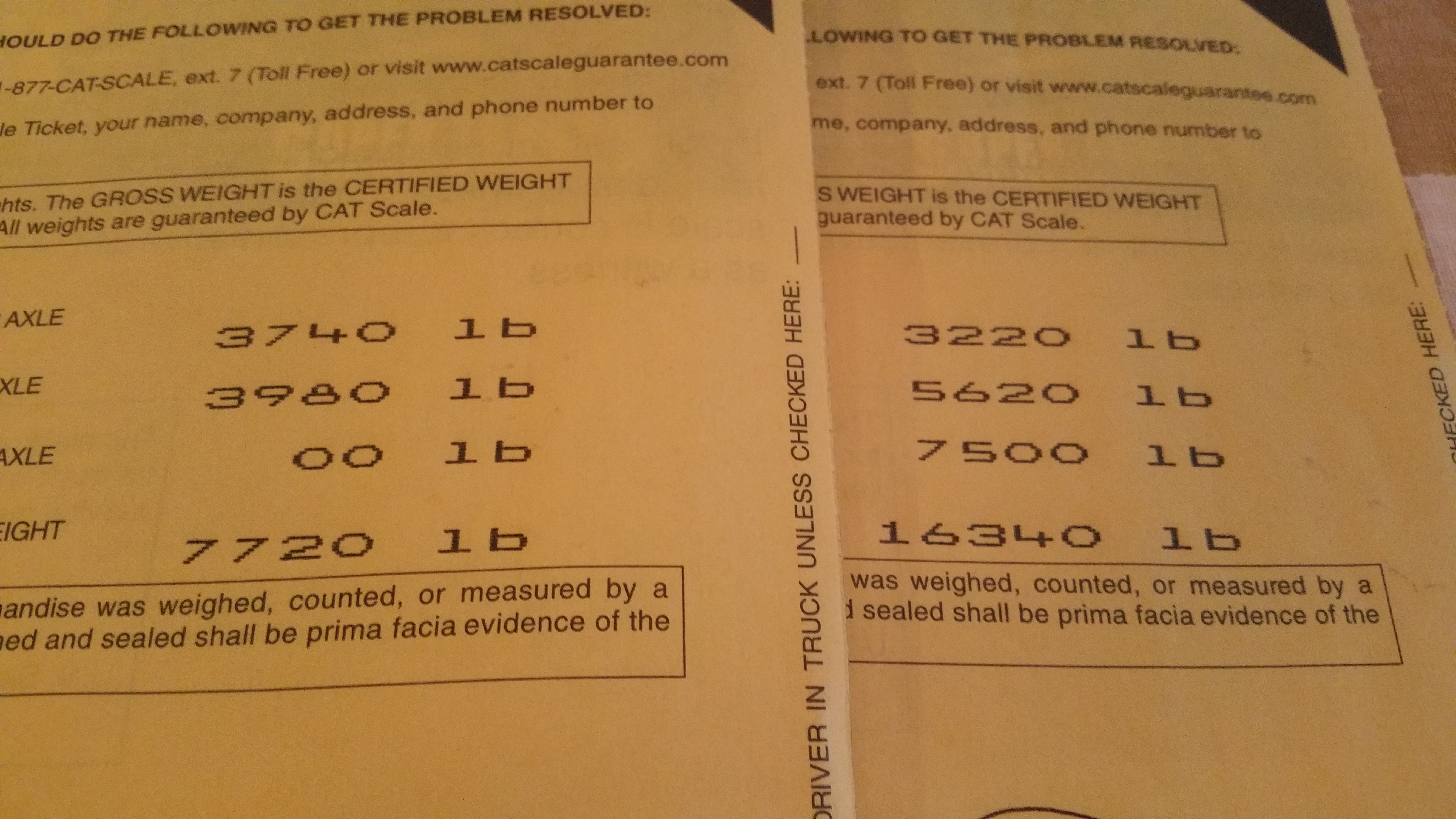

Are you planning to tow the trailer locally, or are you planning cross-country trips?
The problem with Suburbans is the payload. You likely have a 1500-1600-lb payload rating, and if the trailer tongue is 1000, that doesn't leave a lot for people and gear. The second problem is the rear axle weight rating. You probably have a 4200-lb rating, which is easily exceeded due to the extra body panels and glass (compared to a pickup).
If you're smart, and don't pack a ton of crap, you should be fine. I towed a 7,000-lb trailer to Yellowstone with my '01 half-ton Burb.
The weak link is not the transmission (though you should keep an eye on its temp), it's the rear axle. If you're planning long trips, I'd get a diff cover with cooling fins, to keep the temperatures down. My '01 half-ton, now owned by a friend, is on rear axle #4 precisely because I was towing heavy over long distance.
The absolute key to being safe is weighing your rig. Make sure you're not overloading anything. If you can't interpret these, learn and research more before you tow:

Taken from the below link
TRAILER TONGUE WEIGHT NOTES Trailer tongue weight should be 10% to 15% of total loaded trailer weight up to 1,200 lbs. The addition of trailer tongue weight must not cause vehicle to exceed Rear Gross Axle Weight Rating (RGAWR) or Gross Vehicle Weight Rating (GVWR).
Finally, the RGAWR is the maximum allowable weight the rear axle can carry. You can weigh your fully loaded vehicle and trailer at a multi-platform weigh station to determine the weight on the rear axle of the vehicle and ensure that you do not exceed the RGAWR. You can find both the GVWR and the RGAWR on the Certification/Tire label, which is found on the rear edge of the driver door.
NOTES ON COLORADO, TAHOE AND SUBURBAN Trailer weight ratings are calculated assuming a base vehicle, except for any option(s) necessary to achieve the rating, plus driver. The weight of other optional equipment, passengers and cargo will reduce the trailer weight your vehicle can tow. See your Chevrolet dealer for additional details. Trailer tongue weight should be 10% to 15% of total loaded trailer weight (up to 1,000 lbs.). Addition of trailer tongue weight must not cause vehicle weights to exceed Rear Gross Axle Weight Rating (RGAWR) or Gross Vehicle Weight Rating (GVWR). The HeavyDuty Trailering Package (K5L) includes auxiliary external transmission fluid cooler and engine oil cooler.
https://my.gm.com/content/dam/gmowne...ide_122215.pdf

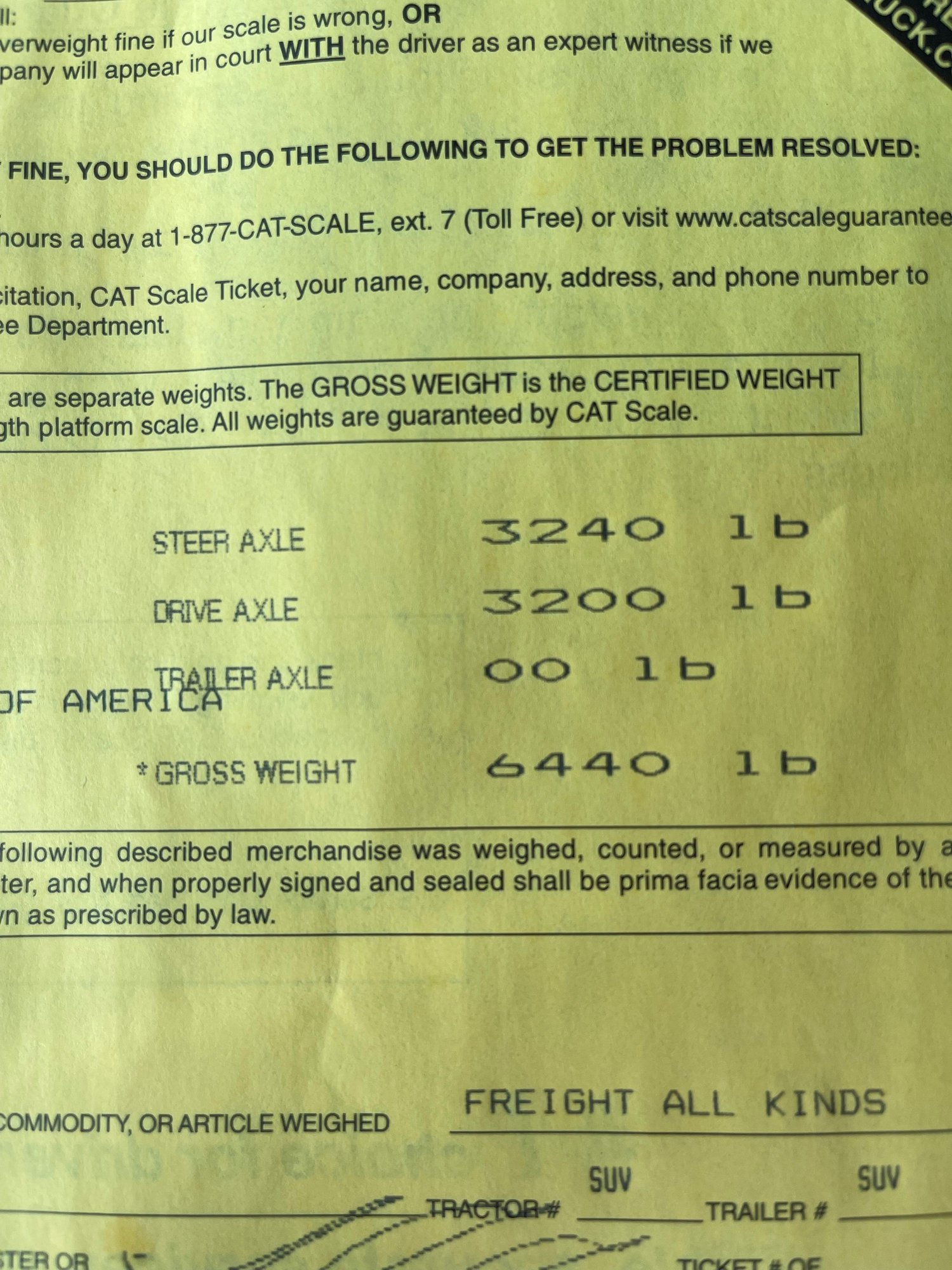

BTW, I recently weighed my 2018 Suburban Premier with 2 adults and 2 toddlers in car seats and nothing else in the back of the Suburban (and no trailer attached). Front axle 3240lbs, rear axle 3200lbs. The gross rear axle rating on my Suburban is 4200lbs. So that leaves only 1000lbs for the trailer tongue weight plus anything else in the back of the Suburban. Hence why I say payload and rear axle rating is the issue.
