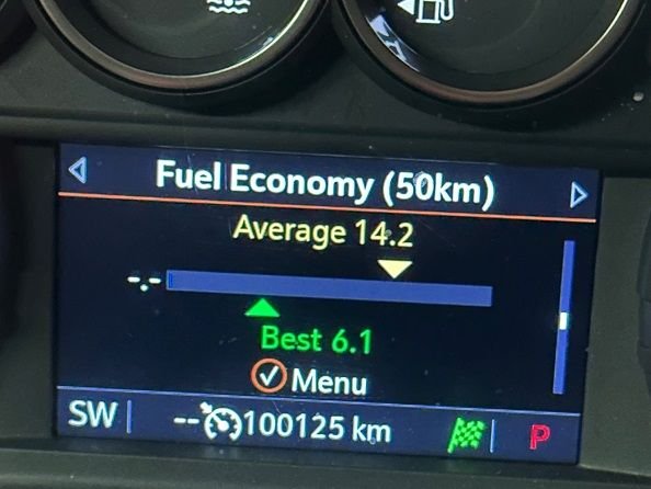

The other day after parking the truck on a cold day - I left it in Auto 4WD - when I started it the next morning a few things came on the display, Service 4WD / Service ESC / Traction Control Disabled. I noticed the truck is still in 4HI and if I push any of the buttons the truck will not shift out of 4HI
Also of note the icon showing if it is in 2WD 4HI 4LO is missing, just blank where it normally is.
