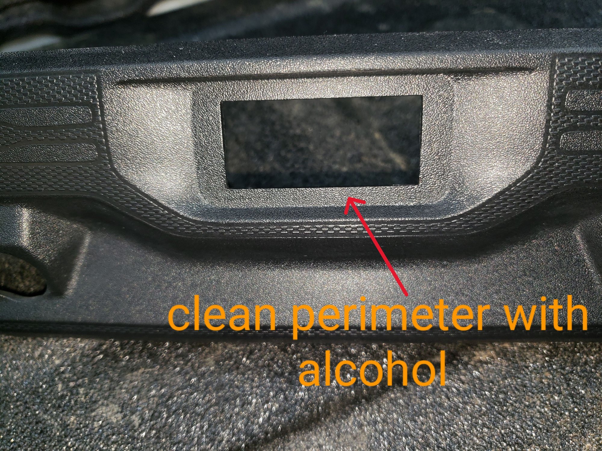

Yes, my 2021 silverado will open at any time and sometimes the button on the gate is inop. I bought a new switch (button) on the tailgate and it fixed the problem but is doing it again. It is caused by water. I took both switches apart and both had water damage. Green corrosion. It happens mostly after a visit to the car wash.
Old Nov 13, 2022 | 2:14 PM
310geneva's Avatar
Joined: Nov 2022
From: Ohio
Default tailgate problems 2500 hd
This is the second switch at 9000 miles. The first switch went bad at 4300 miles. The first thing I notices was that in the rain my tpms would quit working. Then I noticed the tailgate would not open from the button on the gate only would open from the dash button or remote. I replaced that button at 4300 miles and it fixed all of the complains. At 9000 miles I noticed the tailgate would open up while the truck was parked. Sometimes it would open when I opened the drivers door. I took the switch apart and found water again. This time I sealed the area that allows the water to get behind the button. Hopefully this is the cure. I cleaned and re-assembled the old switch so I have a spare.
