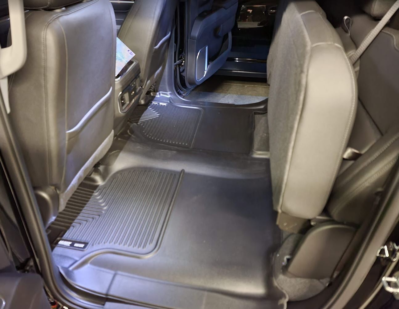

I have it in my 2022 LTZ as well and I am not impressed. I have to say it does sound really good, hearing things in songs I did not hear in my 2016 F150 King Ranch with the Sony system, crisp and crystal clear but the power just isn't there and definitely lacking in the bass department. I moved the fader more to the rear speakers and that helped a lot.
I am going to try and add a powered sub unit as well, nothing crazy but I need to take the rear seat out and try to figure out how much space is back there. I am hoping I can fit a kicker hideaway HS8 or HS10 behind the rear passenger seat. There has to be 3 1/2 inches of space back there but maybe not. I have been trying to find a video or something where somebody shows the space really well but haven't found one yet. I am thinking with all the differences that can be in these vehicles I just need to pull the back seat and check what is back there for 100% sure. I think an 8 would be fine for me but I would get the 10 if it fits. I just put a 12 inch JL Audio hidden spare tire sub (fits in the rim of the spare tire in my daughters CRV). Previously had a ported box with a punch 12 and a 600 watt amp that took up half the room in the back. I was blown away! It sounds every bit as good as the old setup! Kicker is a great company and I see their speakers in these newer Ford systems as well as the GM setup that goes under the rear seat. I don't know how they do it but if their hideaway box sounds as good as JL's stuff it will be more than sufficient for me. I use the full floor in my vehicle a lot in the back so I don't want something under the seats or sitting on the floor that will be in the way.
