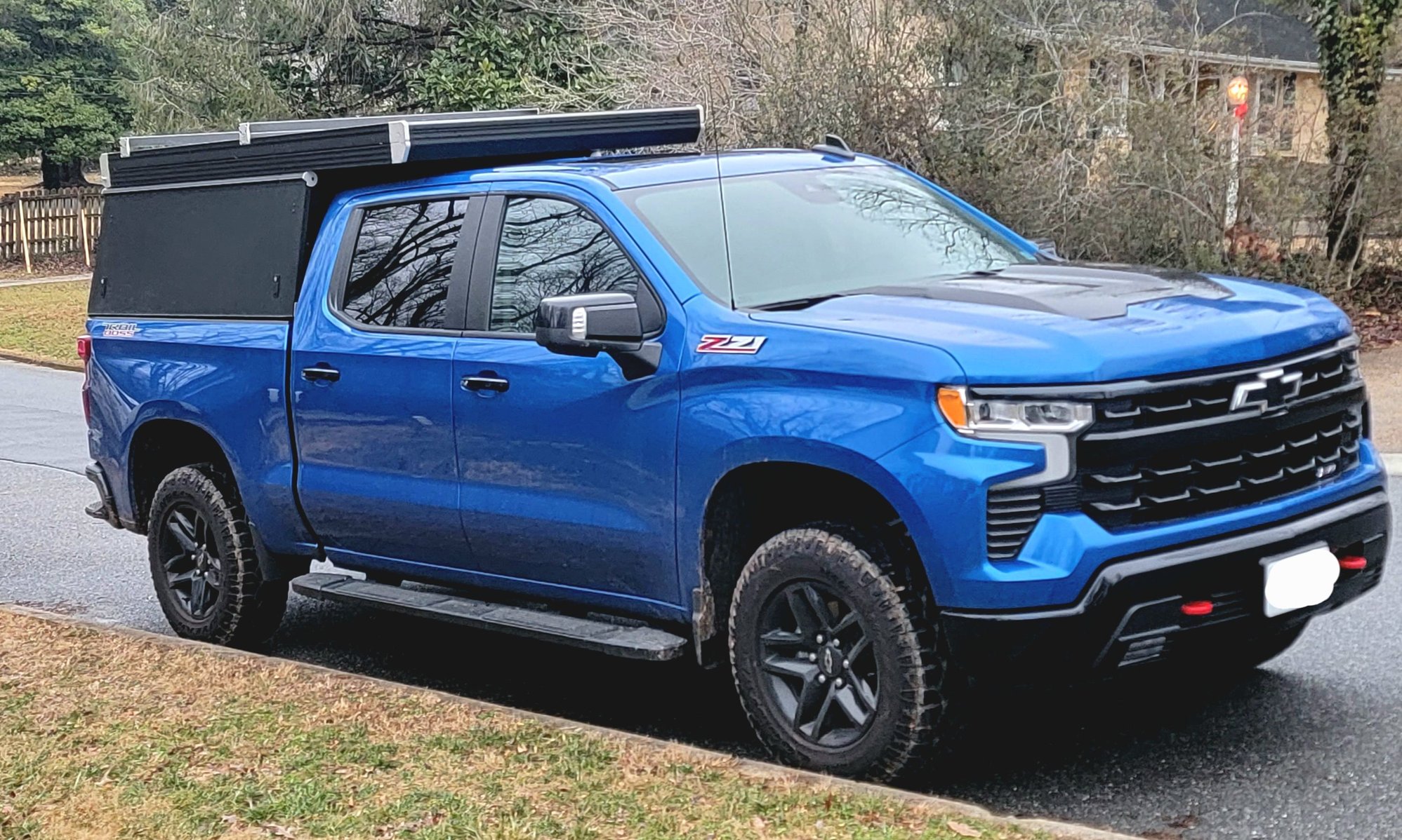

-Howdy Folks-
Wondering if anyone can help me out. Looking for a website/ video that goes over how to wire in a 3rd brake light on a aftermarket cap.
Does anyone knows which wires can be tapped coming out of the tail light... I believe top and bottom lights/ wires are breaks, so I'd assume there...? Just hoping for a confirmation before tapping and potentially causing a problem.
Thank you
Driving a 2022+ Silverado LT Trail Boss.
