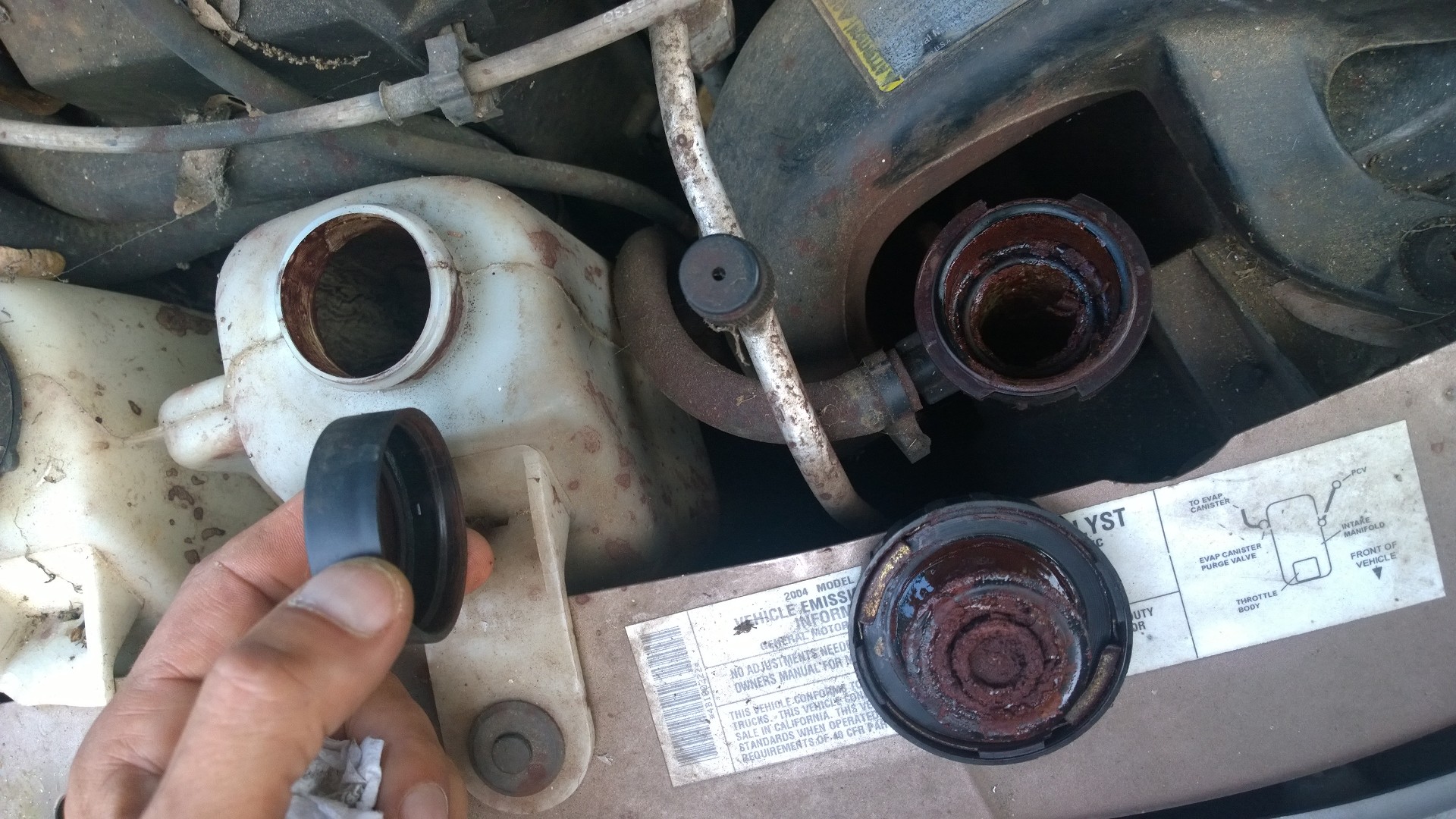

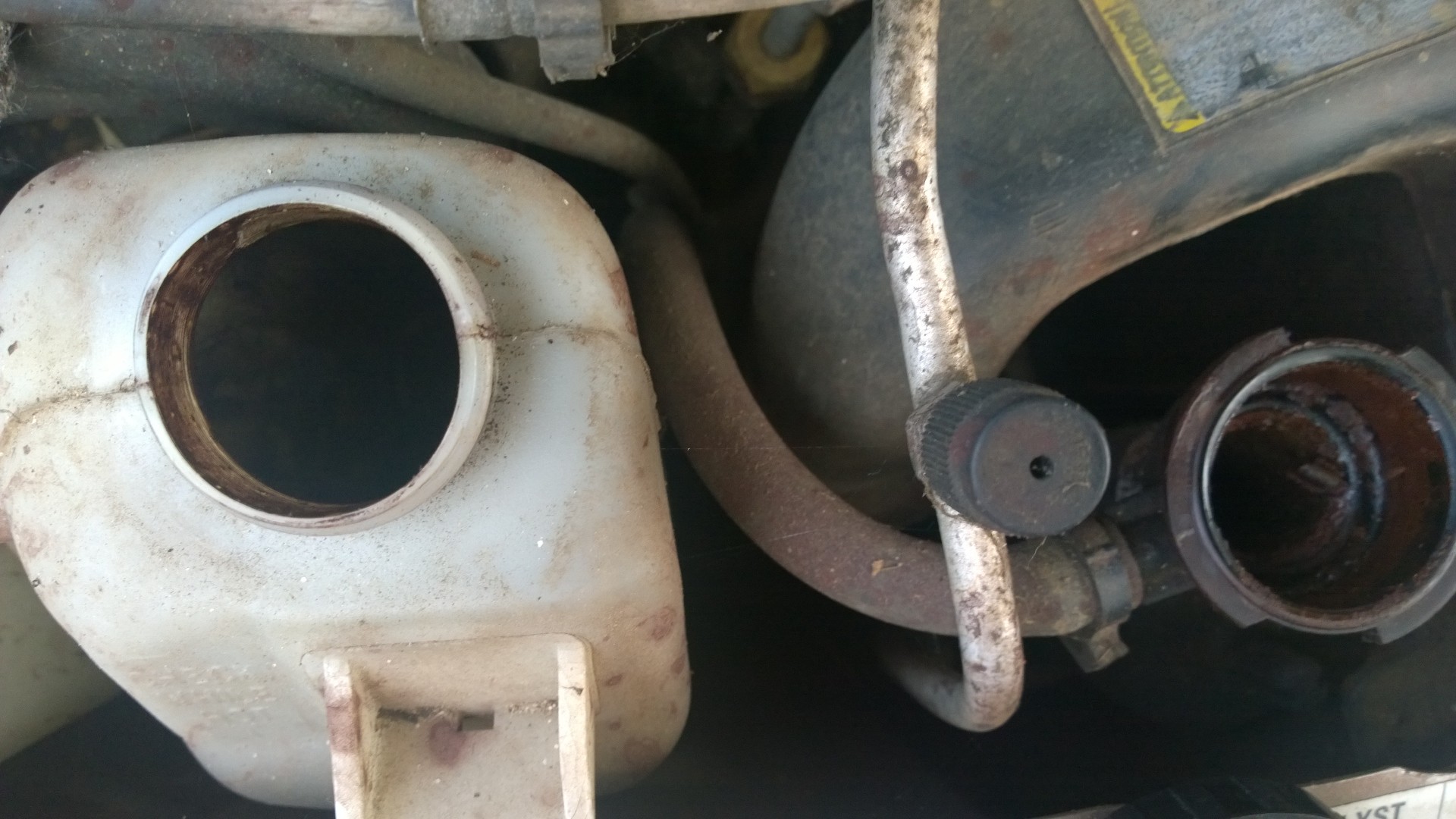

Thank you. We've solved this. I have another question.
It has 113k miles. Owner said it started to overheat and he stopped on the road. Also, he said the head gasket must be replaced. Oil in the engine normal level, there were no liquid in radiator and expansion tank and there is viscous and sticky scurf. How can I wash the system and what it could be? It looks like rust metal and old antifreeze. Engine uses synthetic oil.

Looks pretty nasty. I would start by putting plain water in it and see if it circulates thru the block and if you have any leaks. Next I would pull the radiator out and take it to a shop to have it cleaned out and pressure tested for leaks. The over flow tank can be removed and scrubbed out with a bottle brush or something similar. If you plan to keep the vehicle, I would also back flus the system to clean out your heater core and maybe replace the hoses if they are soft or cracked.
