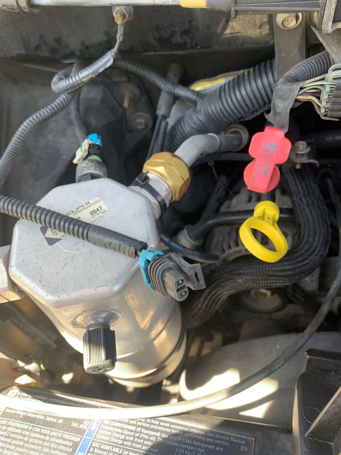

Connection near a/c receiver, cannot figure out where it goes???
Old Apr 2, 2023 | 3:26 PM
timg214's Avatar
Joined: Apr 2023
Default Connection near a/c receiver, cannot figure out where it goes???

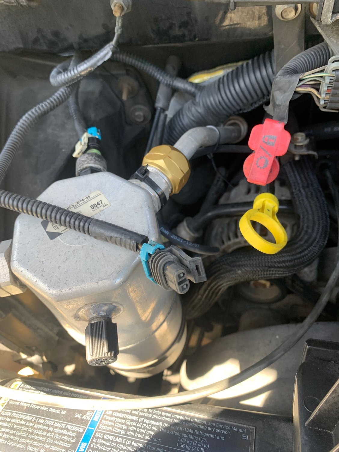

See pic, thank you
Old Apr 2, 2023 | 3:34 PM
Rednucleus's Avatar
Joined: Jul 2014
Posts: 2,334
Likes: 308
From: Marysville, WA
Looks like it's never been used. Probably for something not on your car.
Old Apr 3, 2023 | 6:59 AM
GWD's Avatar
GWD
Joined: Feb 2022
Do you have a rear heater behind driver seat.?
If not then this is the plug for that valve that is mounted behind the air-conditioner tank along the wall.
Old Apr 5, 2023 | 4:18 PM
oilcanhenry's Avatar
Posts: 4,605
Likes: 269
From: USA
The "receiver" isn't your receiver/drier and it looks like you low-pressor sensor is hooked up. So if you cannot find a plug-in for it, it may just be an accessory plug that you vehicle doesn't need it for. Most cars come with looms for parts that are not found on some vehicles. Yours might be one. I'd look all around myself.
