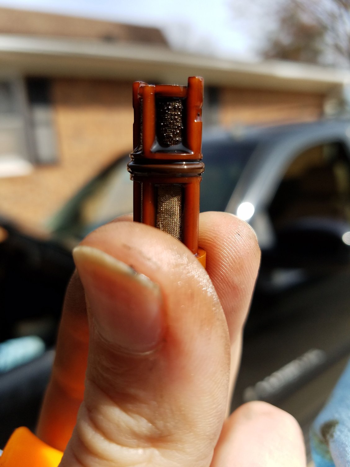

Old Apr 8, 2019 | 5:54 PM
jpaws68's Avatar
Joined: Apr 2019
Posts: 7
Originally Posted by Kivansh
So recently rebuilt the entire engine
yes i changed the oil pump and sensor and all the bearings,camshaft,crankshaft.
on cold crank it stays at 40-45
when engine worm up on smooth drive like 40mph stays 20-25 and more i fast the higher psi go up highest 40
and when it come i stop at idle like traffic it drop to 0-5
and oil pressure light comes on and says turn engine
off.. i did changed the oil already to clean up inside motor. what else i need to check? Please help i dont want to ruin my new engine
I have an 07 Yukon with the 5.3 engine. I have removed the oil pressure sending unit now 3 times. Mine has a small screen under the oil pressure unit that gets clogged up with gunk. If you just remove the sensor BUT do not remove that small screen most likely the problem will return almost immediately. It is fairly hard to get to that part to remove and reinstall.
