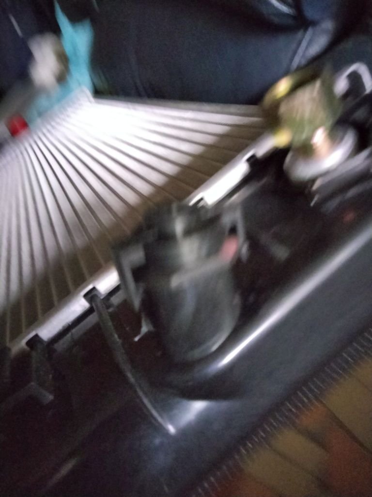

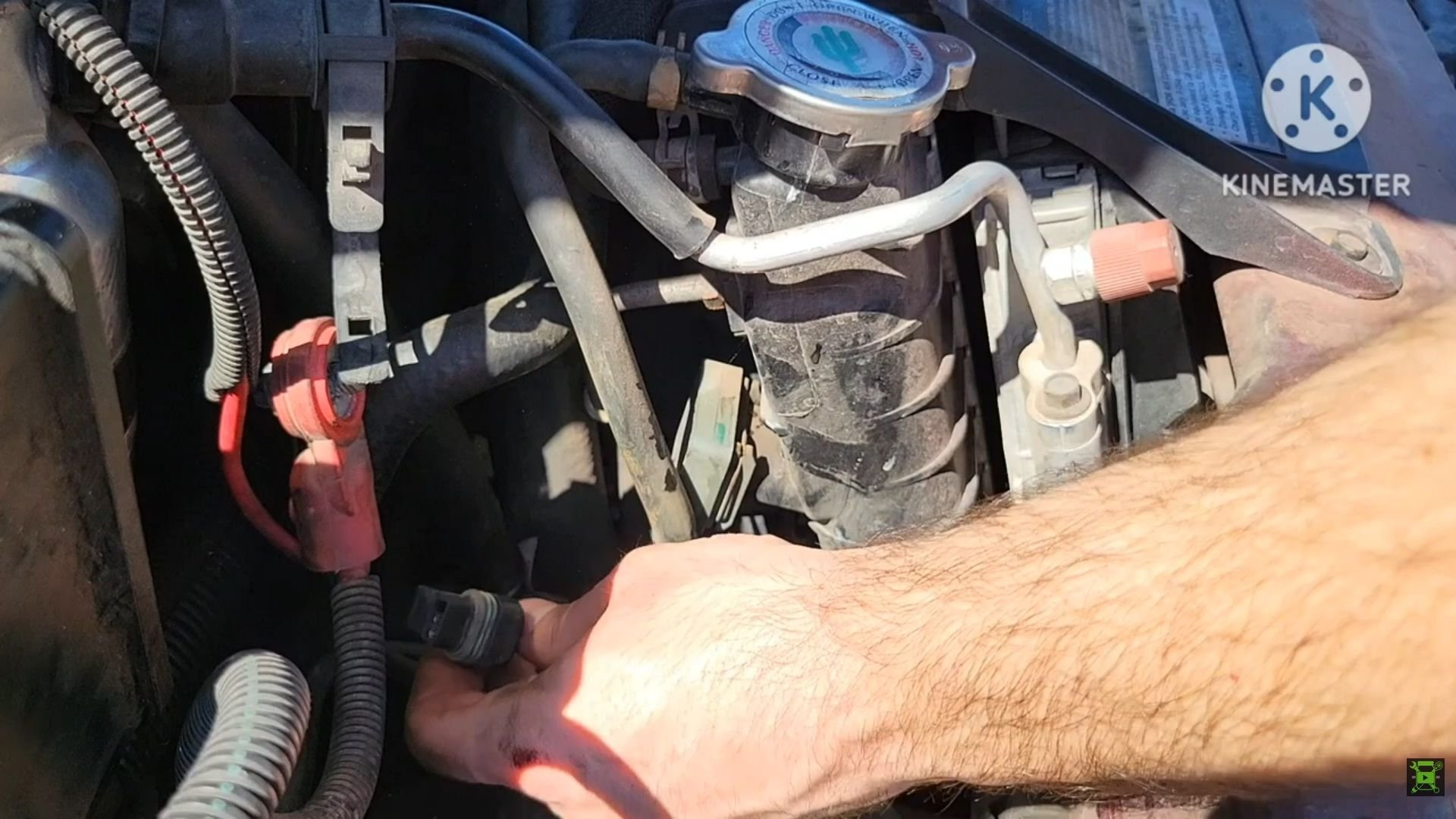

this replacement rad. seams real flimsy right at where the fan sensor is. it feels like if I pry up on the retaining clips it would crack the port. I believe this rad is designed for the 02 models which didn't have this sensor at rad.
OK I see the clip looks like he pressed downward to remove the clip then it just pops off on it's own?
