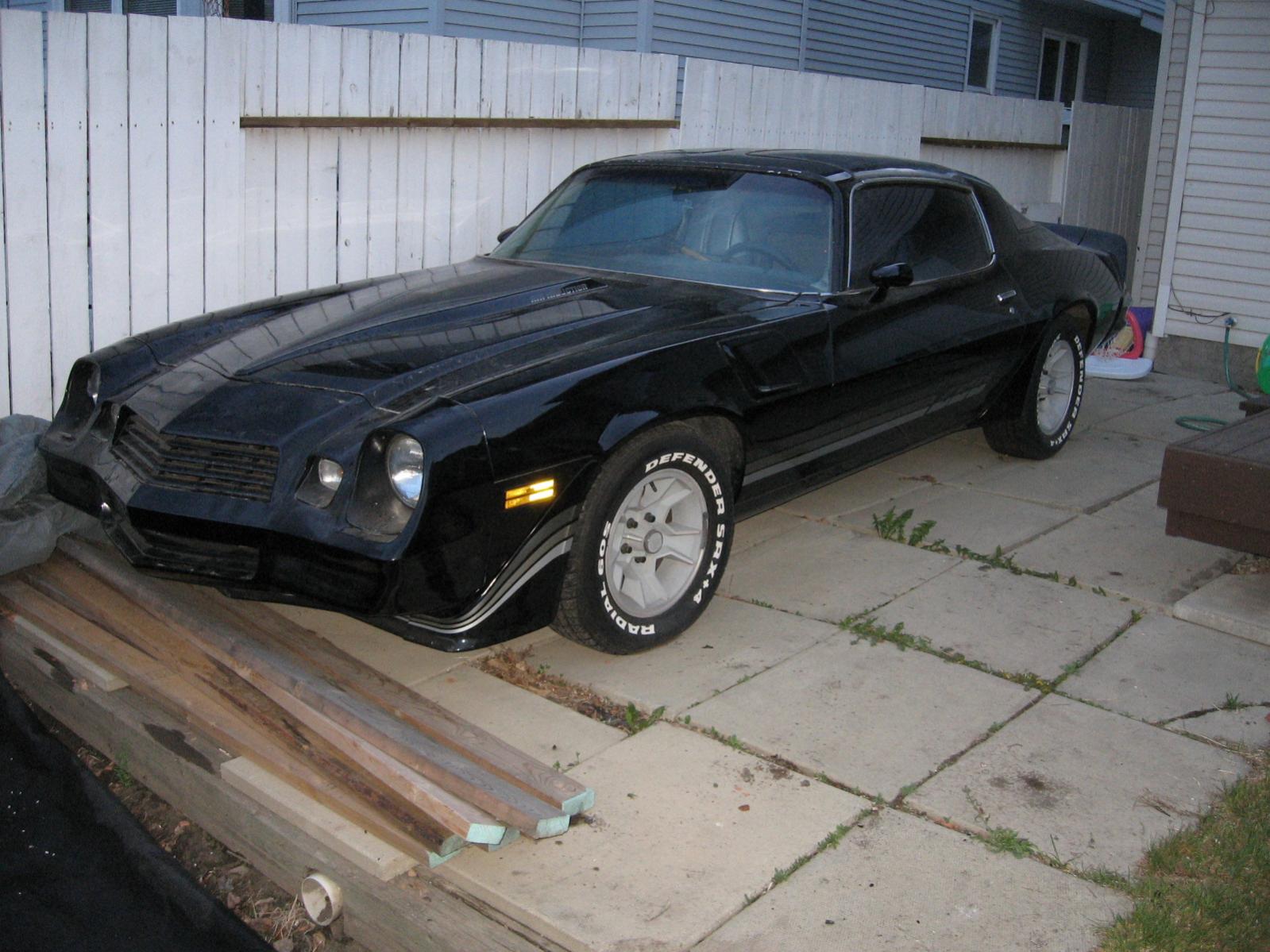

Hey There........I have an 81 Z-28 that I have had for year, I did a couple of mods done to it like a high rise edlbroke intake and a crane cam nothing to crazy....man I wish I would have done something with the heads!! ...but now I would like to change out the carb, the one thats on it now is the factory 4 barrel (rochester) any suggestions???

I do have a square bore edlbroke intake...I have been hearing good things about the demon carb? do you think that would be a good match?Carb/performance-my-z-28.jpg
