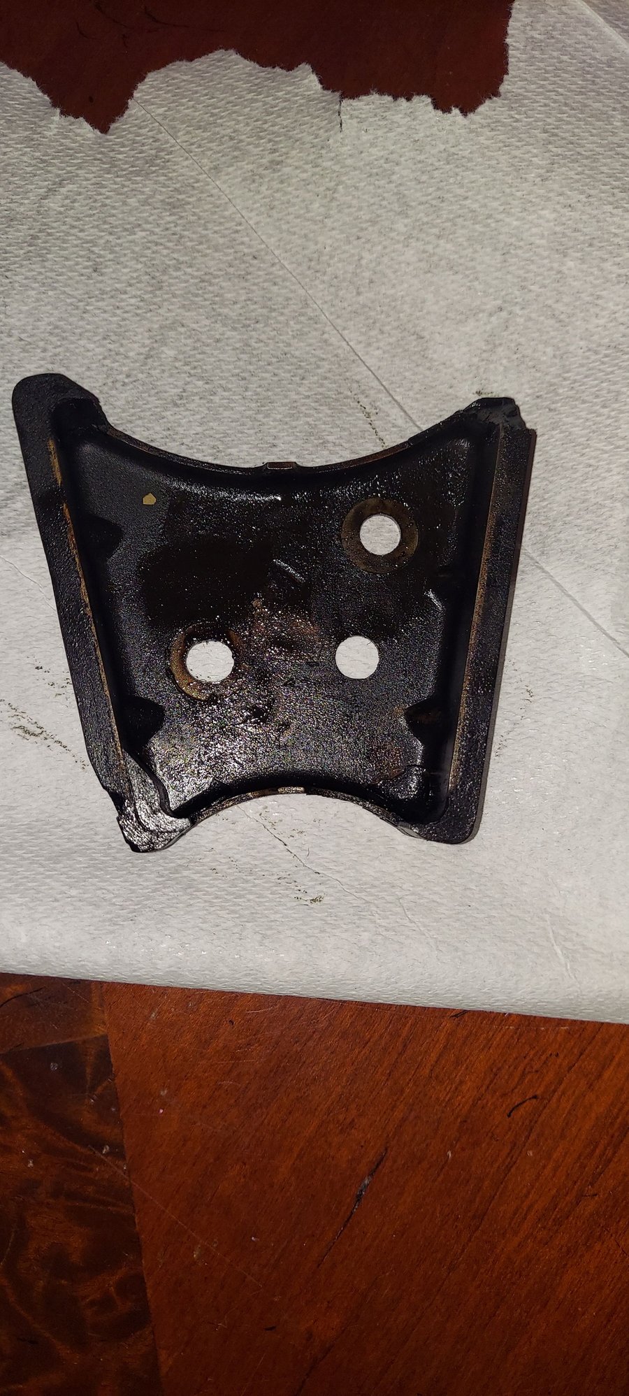

Hi guys my 95 3.4 v6 camaro is making noise sounds like it's coming from the top end in the camshaft area does anybody know what it can be
Old Mar 14, 2024 | 8:08 PM
3400camaro's Avatar
Joined: Mar 2024
Update I took off the timing cover and saw the timing chain guide was chewed up and the chain has alot of play to where its hitting the guide and making that noise after I took the guide off and spun the engine everything is fine but I'm still looking around for the chunk off that guide cause it wasn't in the oil pan
