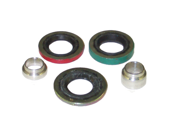

The new R4 compressor uses sealing washers . I put the gold / brass / thin one on the suction line . Also came with red and green sealing washers for the high pressure line . I used the green / thick one . Did not use either the thick or thin insert ? Could not figure them out ?

I will try to get some new o-rings for the accumulator . Did I mess up on the sealing washers ? Should I have used the thick insert with the thick high side sealing washer ? One side has a " step " machined , to a little smaller diameter . Does the step go inside the end of the metal line ? Or towards the compressor ?
