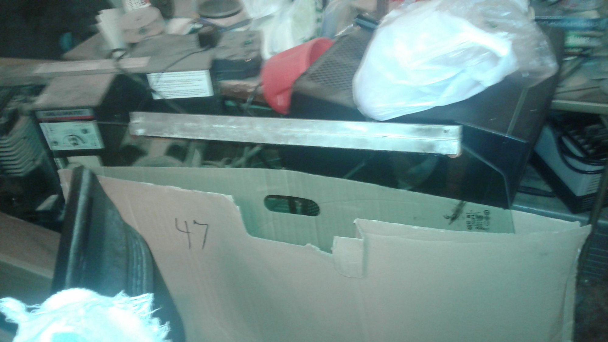

This appears to be the correct glass . The 2 holes in the bottom of the glass line up with 2 holes in the aluminum piece the old glass was glued into . I bought 2 1/4" x 20 tpi plastic / nylon screws & hex nuts . Going to use those , hopefully , to do an initial trial fit . Before I apply adhesive .
With a long / narrow screw driver & hammer I got the old broken glass out of the grove in the aluminum piece . Using a new , sharp blade in my utility knife ( and the screwdriver ) , removed the old rubber adhesive .

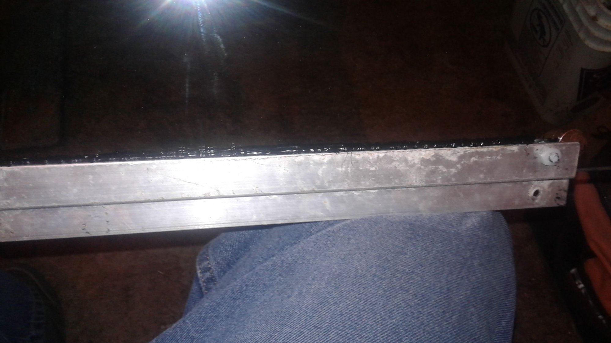

Old Feb 1, 2017 | 4:44 PM
WyrTwister's Avatar
Joined: Jan 2013
Posts: 267
Likes: 5
From: USA
Not too professional looking . But I hope it is good enough .
Used 3M Window weld # 06909 urethane adhesive .
Two plastic / nylon screws & hex nuts locate the holes in the glass with the 2 holes in the aluminum strip .
Groove in the strip was about .2" wider than the thickness of the glass . Tried to use Popsicle sticks & wooden kitchen matches for shims , one on either side , to the left & to the right of the screws . No go . Finally settled up on 4 pennies . 2 at each end .
Will probably let it set until after lunch tomorrow .

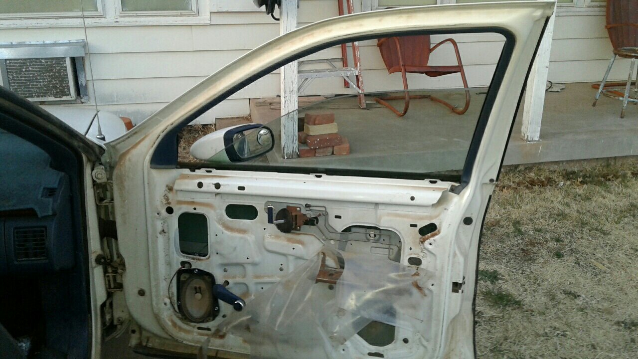

1991 Chevy Caprice RF door glass
With the help of my Wife and several prayers , the glass is in the door . Far as I can tell , still in one piece .
Praise the Lord ! :-)
The aluminum strip the glass is glued to & the strip that the regulator operates ( up & down ) were originally pop riveted together . Could not get a pop rivet tool in position , to operate it .
Considered screws & hex nuts , but could not find my " tray " with assorted sixes & lengths . Ended up using Teak ( hex head self tapping screws ) . My cousin had suggested using LockTite , if I used screws & hex nuts . Excellent suggestion .
I found that a large enough diameter Teak screw , the hex head of the screw wedged inside the " track " , that the plastic glide clip slides in . Tight enough that I do not think it will ever vibrate loose / out . Even w/o LockTite .

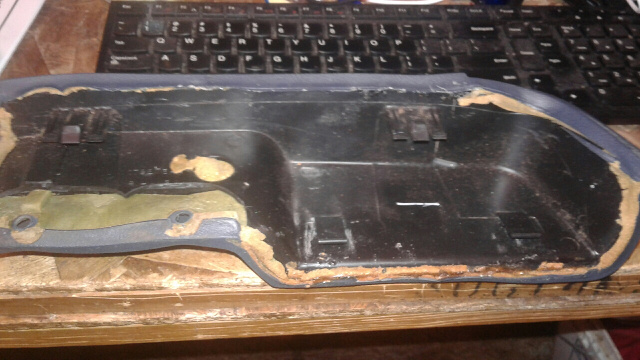

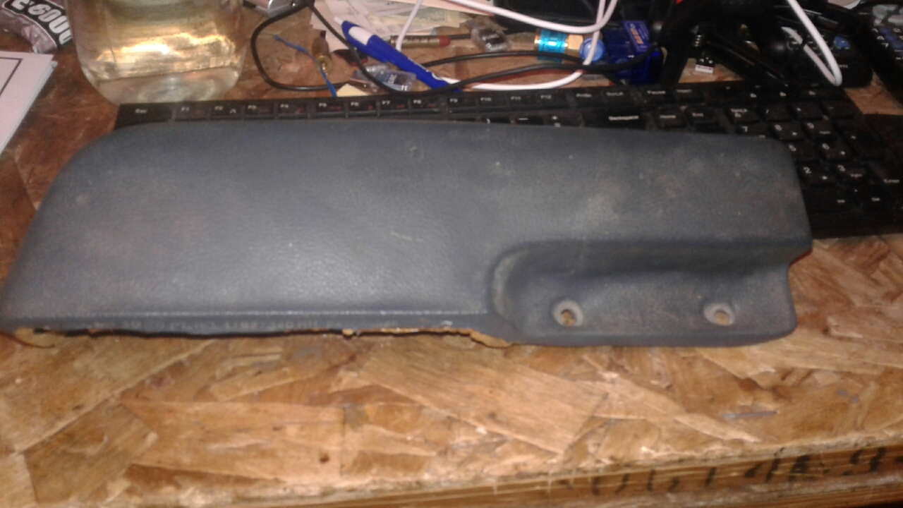

Also attached are photos of front and back side of the arm rest . Made some repairs with E6000 adhesive . Need to cut a piece of plastic , for the broken area of the back side & glue it in . To finish the repair . Pick up some screws and appearance / trim washers . Hopefully at O'Reilly Auto Parts . Then do the same for the driver side arm rest .

My Wife helped me put the door back together , yesterday PM .
