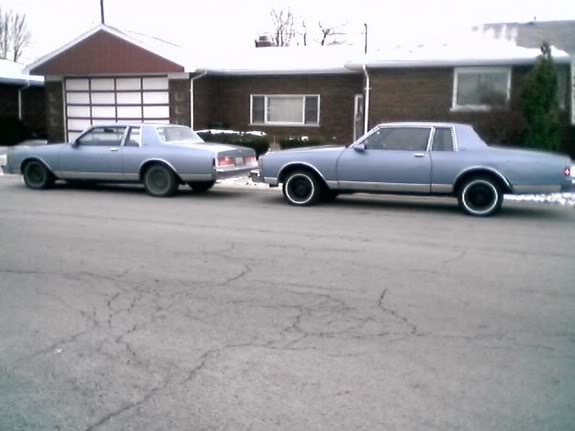

Is it a 2 door or a 4 door? If it's a 2 door don't modify anything if it's already stock, that's what I'd say. If it's a 4 door anything goes. I've got a '87 Landau and I've been putting in more work into making it stock than anything else. When I got the car it had a 350 (from a Suburban) in it and had been painted. I'm bringing it back to it's stock color and am currently considering swapping the 350 out for a rebuilt 454 and TH400. If it had the stock 305 in it i would just rebuild that and keep it but since that's long gone I might as well go nuts. The '87 2 door is basically the '57 Chevy of the 80's I say. Anybody has some more insite I'm open for arguments. 313hitman's got the right idea about easy upgrades, I've always been a fan of swapping out for police package stuff. Reggie.
