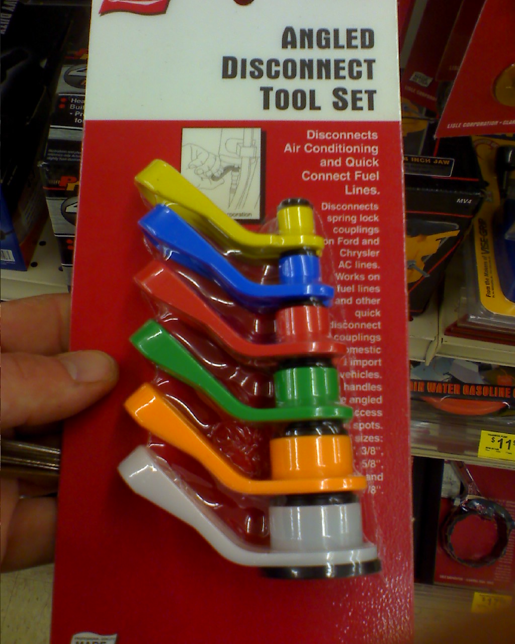

Yes, as me and my brother found out, you have to drop the tank. Make sure you have the right tool to take off the fuel lines-they are a PAIN otherwise. I'll try to attach a picture of what the ones we used looked like. They worked really well.
