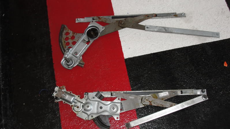

Pulled passengers window regulator & wire harness from a cavalier with power windows. Drilled out rivets and removed regulator. Installed power window regulator. Door panel has hole from old crank, but going to mount a tweeter in that hole.
