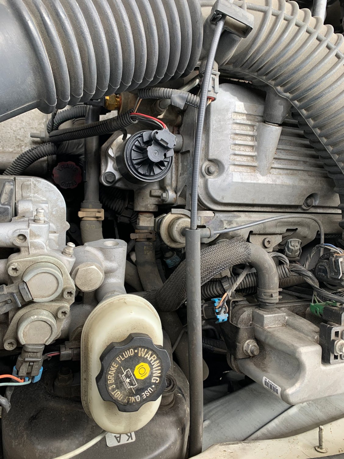

I need to replace my canister purge valve on a 1998 cavalier. I have the replacement part but I can't find the part. Can anyone help me locate this?

I have a check engine light P0442, already changed the fuel tank cap. No noticeable performance issues. It is a 2.2 liter. I have a diagram from parts store showing it is on the top of engine but I don't see it. I have replaced this part on other vehicles so I know what it looks like and I have the replacement part.

Top view of engine
Side view of engine
The part i need to replace

should be left of the throttle body and near the tps sensor. can't see it in your pics
if the purge doesn't fix it. I will walk you thru some testing.
