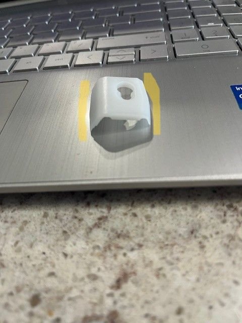

I am having trouble re-attaching the front bed trim on my '72 El Camino. This is the piece that mounts to the body about 2" below the rear window. I am using the OEM nylon clips, but can't figure out how to engage the chrome trim piece with the clips. They don't just "snap" over the edge of the clips. Any tips on how to do this is very much appreciated.

Those are for the side rails, and those are easy. I'm talking about the "front" rail. These are the mounting clips. The edges marked in yellow are supposed to engage the metal trim rail, but I cannot get them to do so.

Sorry. I didn’t have to change that piece. Did you try installing the clips into the trim and aligning the bed pins into the keyholes in the clips and pushing it to lock? Sorry if this is a lame answer. That’s all I can guess looking at your clips. Good luck with your install.
