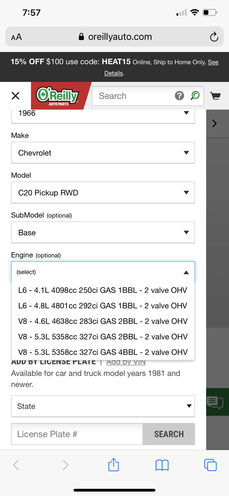

good to know that information, my mechanic said it had a 327 engine I figured is a 5.3L since when I order parts that’s the only option I get for this 327 engine
I don’t know what type of manual transmission is on it but the shifter shows 4 gears and the R for reverse and the carburetor is only a 2 barrel Rochester
Truck is running now, shifts good but is too slow compared to what I’m used to driving
it sucks gasoline like a thirsty camel
this is what the parts site ask for when ordering for parts I’m attaching the image of the options offered base on the engine size

If you do the calculations, 5.3L equals 327in³. Thank Jimmy Carter for switching the USA to metric. 😠

True enough but the 5.3 is not the same motor as a 1966 327 motor is.No fuel injection and lots more, as I am sure you know, 73shark.
