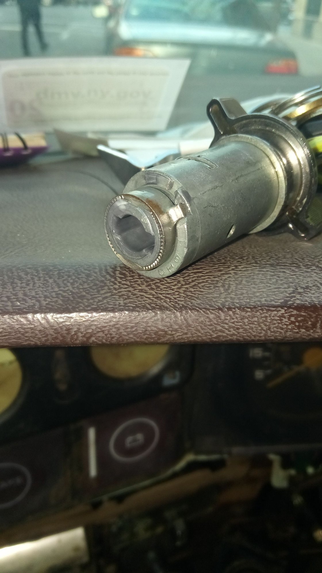

This should be an easy fix but maybe GM is making me go back to school. I have two issues with the column.
The truck is a 1981 C-10, automatic,with an even older replacement non-tilt steering column.
1. Earlier this year I had the steering wheel off to replace the turn-signal switch. At that time I noticed the rod that is supposed to engage the lock-plate was not extending when I would turn the key off. I couldn't figure out how to get the push rod from the lock mechanism to seat into the block that extends the steering wheel lock-rod. I can see the key-geared rod move back and forth when I turn the key, but IDK what I am overlooking. How is the pusher rod supposed to be secured to the block?
2. I had the wheel off again today to try to fix a lock-cylinder that won't reverse to turn on the accessory position for the radio. It was binding, but even though now it is lubricated, and seems to work freely, I am not getting any radio operation. The radio works fine on the run position. Maybe that is an electrical switch adjustment . .
