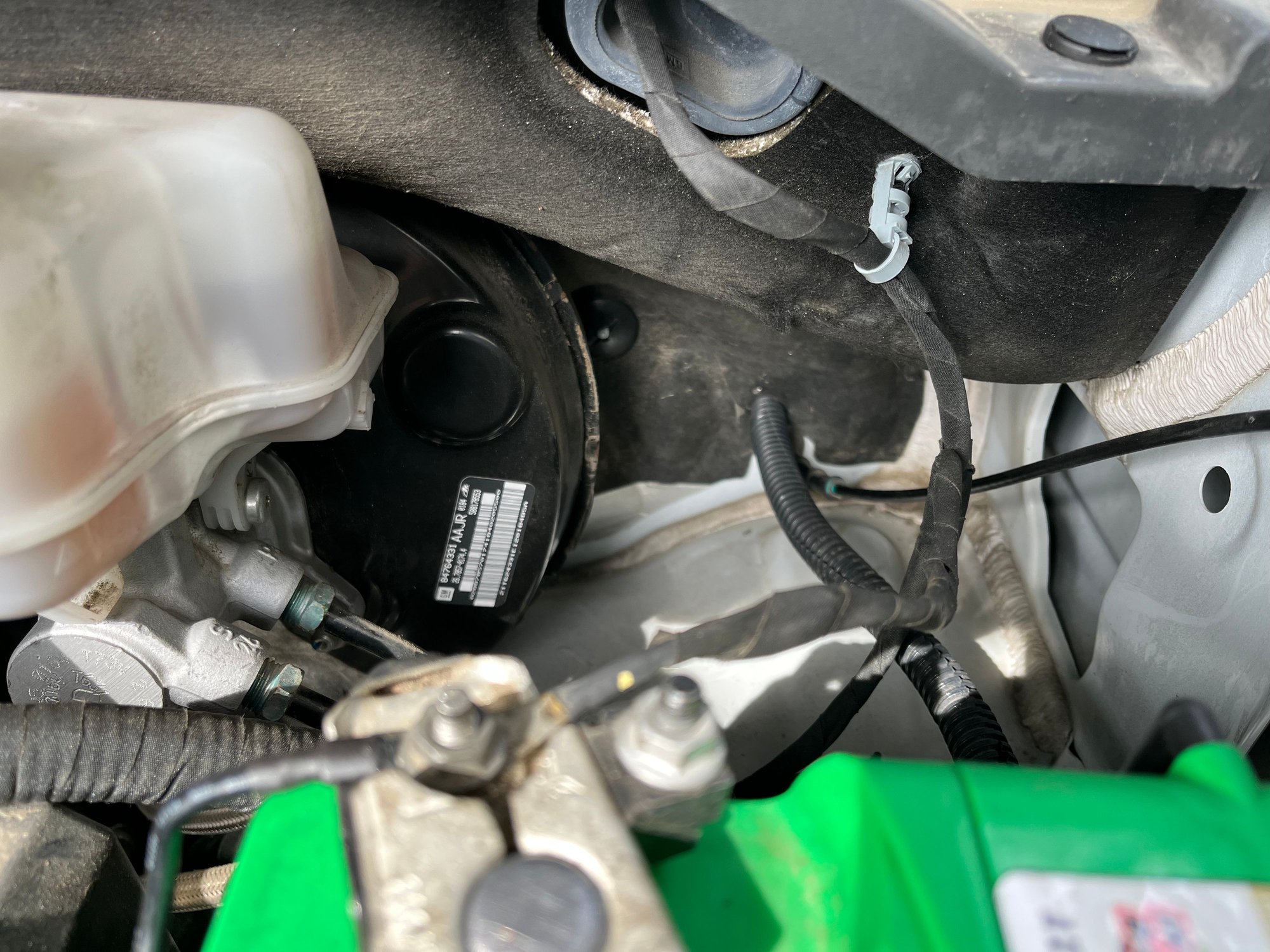

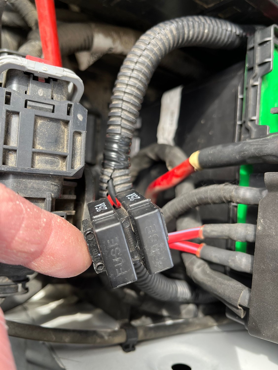

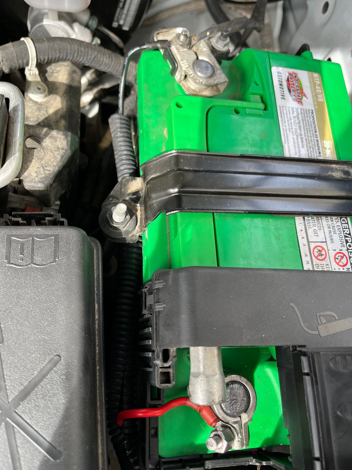

Well Thanks Oldchevy, I managed the install and thought I’d share what I did in case some other ham has the same question. I pulled my power for the radio straight off the battery
fuses
through the firewall
radio location

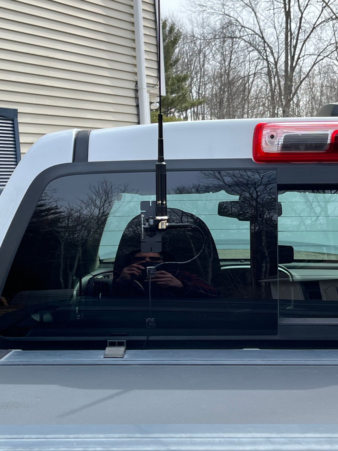

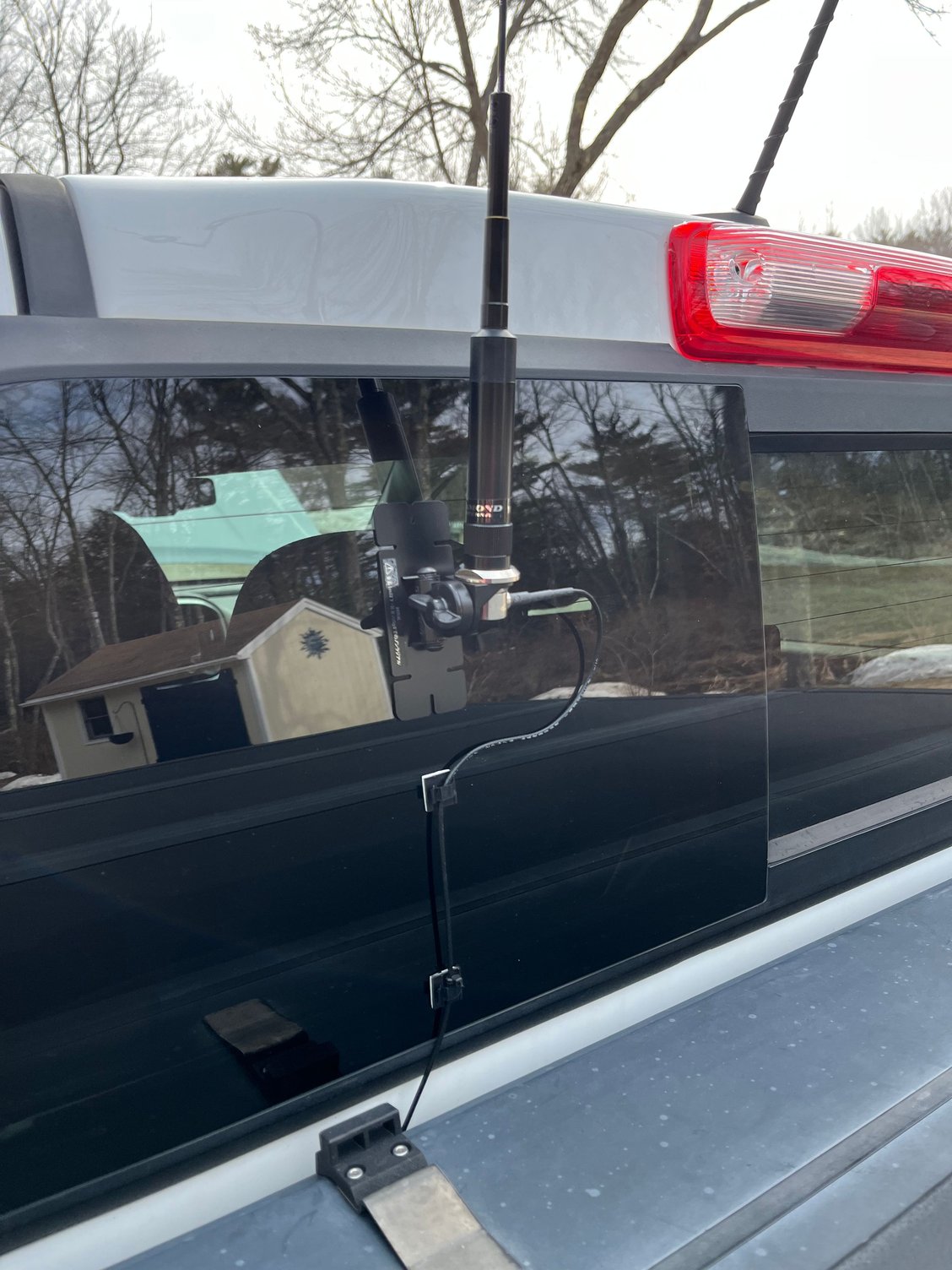

antenna location
I flew the antenna wire in the cab through the cab vent located directly below my antenna between the body and the cab then in the chase inside the door threshold to the front and untimely to the radio. I had pretty much the exact set up in my Silverado for years so I just did it again on the Colorado.
