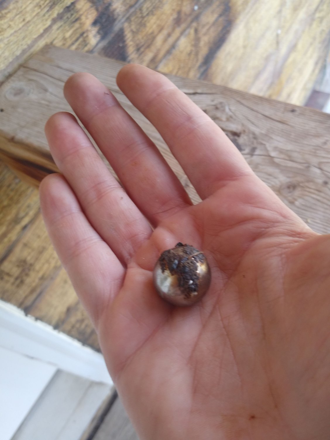

Ok so I have a 2013 Eco. About a week before this happened my car was making a really bad clunking noise on slow turns. I parked it until my husband could take a look and see what was going on. When we went to pull out of my drive way it made the clunking noise followed by a really loud screeching/ clicking (that's the only way I can describe it without sound effects lol). Tried to reverse and put it in drive and it wouldn't go anywhere. Just made that awful noise. Turned the car off and it has sat there since. Husband thinks it's the transmission but I was looking in my drive way and I have found 3, 3/4" ***** from underneath and beside my car. Any ideas if they came from my car or maybe this is the problem? Or any ideas on the problem? My car only has 90,000 miles on it.

looks like a ball from the constant velocity joint....part of the front axle shafts....inspect both front outer boots.
