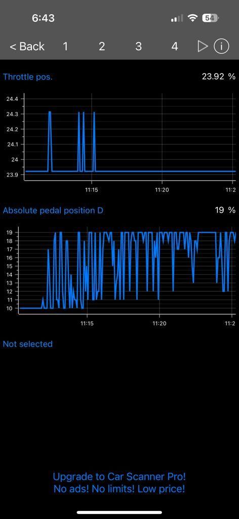

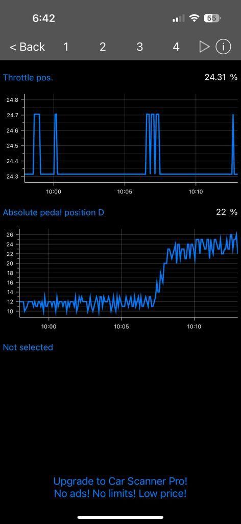

Thank you @mountainmanjoe I did tried to look at the throttle pedal wiring harness and connection and found no issues so far. The obd code p2122 said Accelerator pedal position sensor/switch D - low input. From my research, the most common cause would be worn out throttle pedal and thought it would be easy to replace it. on further investigation, I connected to collect live data and seems to me the pedal is working fine, when I depress the pedal it does increase the Switch D position percentage, please see the image below for referrence. However I observe other abnormalities, the pedal position percentage itself fluctuating both in depressed and idle position. The Throttle position has no change co-relating to pedal position and it by itself fluctuating as well irrespective of the pedal position. I am guessing now that it might be a throttle body position sensor/wiring problem instead of pedal position sensor/wiring, am I guessing right? if so is there a chance the ECM throws P2122 even though its throttle body sensor problem.
throttle pedal idle position
throttle pedal depressed

in a throttle by wire system, the computer controls the throttle, so it will make continuous small adjustments to maintain a target RPM, even if your pedal position doesn't change. It's only changing by fractions of a percent.
But your pedal position values are bouncing a lot. I'm pretty sure these sensors are simply potentiometers ,so they should produce a smooth voltage output.
I'm not sure how much yours cost or what the availability is, but there are videos of people opening them up and cleaning off the contact surfaces.
