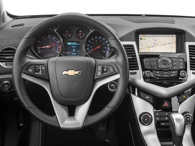

Unfortunately I got the cheap version of it (see image below)
But I would like to replace it to this (have all the audio controls on the wheel and so on) :
I saw a video of how to do it on youtube:
and more or less I got the idea of how to do it, my question is: Would my car with the blub of plastic wheel that it has (no buttons or audio controls) will have the plug for the steering wheel buttons, and if it does would my car will know how to route those buttons to the correct functionalities straight out of the box?

GENERAL STATEMENT...most newer models, like yours, do not have the wiring for options not built with present.
adding it is not easy as cars today use CAN BUS computer architecture. So the wiring would have to be added and then the system programmed to recognized the added options.
In short, the steering wheel would fit but the additional buttons probably wont work.
