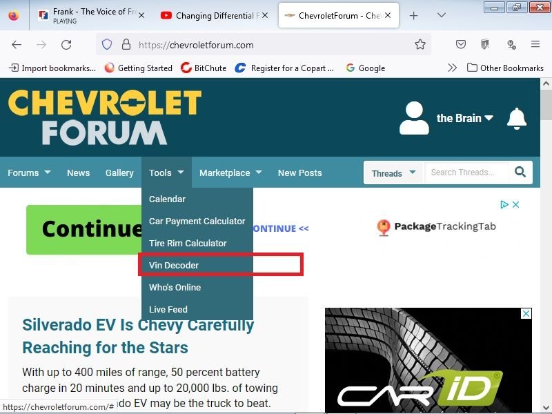

[QUOTE=the Brain;484826]
I’d like to be able to decode the vin decode.
/QUOTE]
you can easily decode through the vin decoder
Old Nov 30, 2022 | 12:33 PM
the Brain's Avatar
Joined: Jun 2016
Posts: 278
Likes: 7
David this is what I used thanks
wyn-fox yes I'm on the look out for a used ad244 which is a 145amp.also plan the big 3. I travel on 200-250 mile trips one way. so I carry spare parts and tools just in case.so far I only have a drive belt for my new 04 3500. thanks
