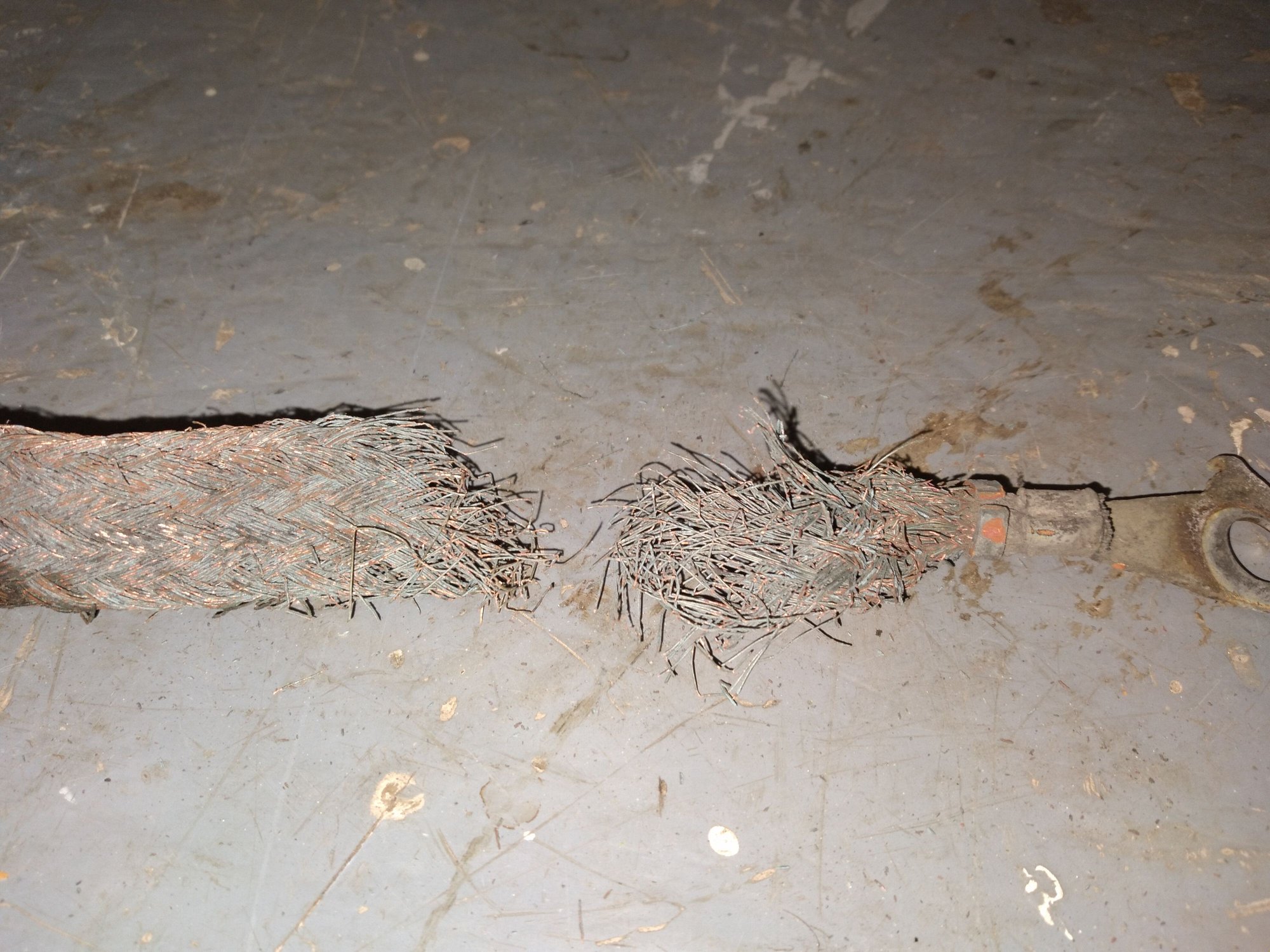

Well, this van is fixed. The fix was something so simple that
it would be overlooked by most mechanics, including myself.
I am a retired mechanic,but, In my 40 years as a mechanic
I have seen this part fail maybe 6 times.
When I have seen this part fail, the vehicle would not start.
Until now, I have never seen this part cause a partial failure.
The part that failed is GM part # 88986775
I am not the one that fixed it.I give that credit to a GM dealer mechanic.

That part number comes up as a battery cable but it looks like a ground strap. Was the entire cable replaced or did the tech just replace the damaged section?
