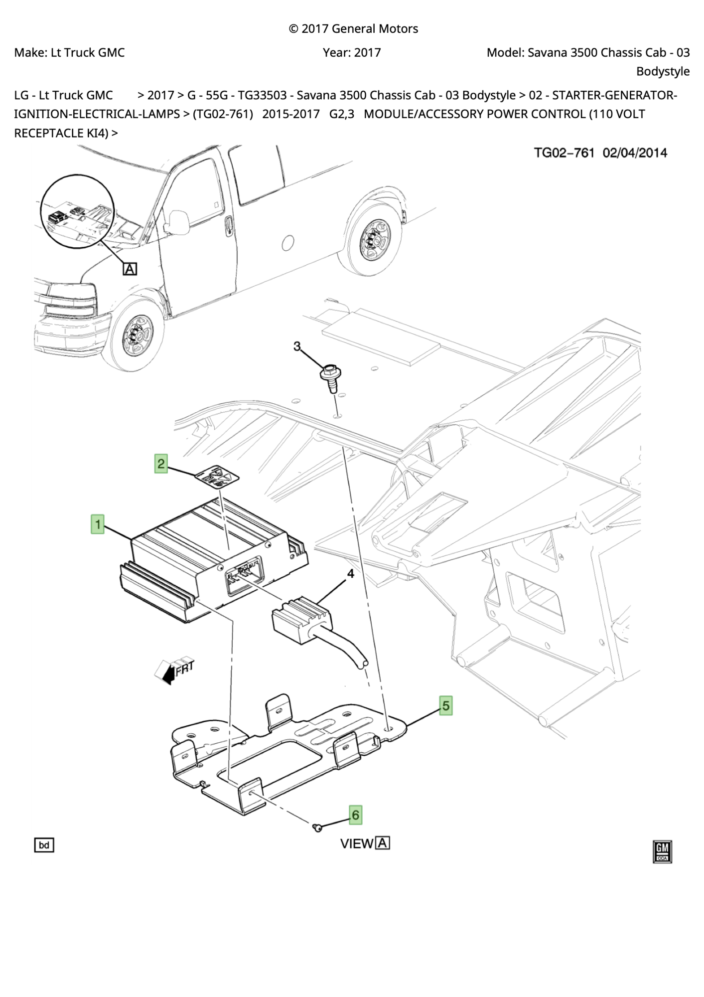

inverter location
Old Oct 9, 2023 | 2:04 PM
2018E2500's Avatar
Joined: Oct 2023
MMJ, Would you say that is the top of the dash assembly, under the dash pad? Or is that a view from the bottom?
Thanks!
Old Oct 9, 2023 | 3:00 PM
you have to remove the dash top

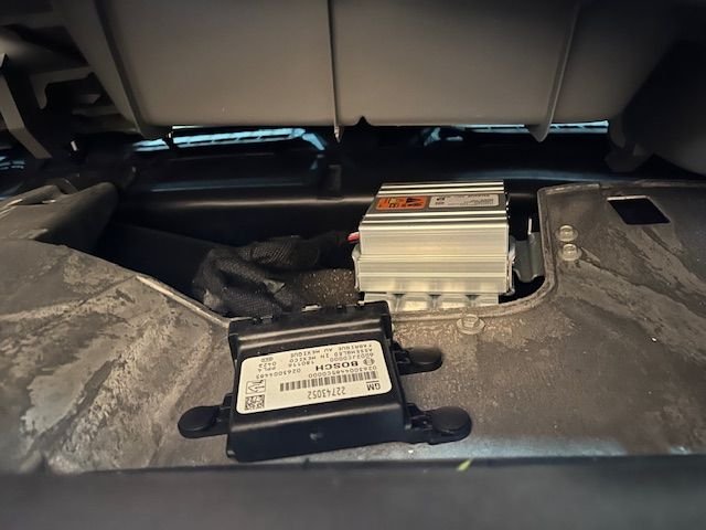

BIG Thanks to MMJ for the information. Finally got around to changing the module this morning. The job was relatively easy, I popped the front bezel loose from the dash without removing it, allowing access to 4 screws that hold the dash pad in position, Remove the screws and pull the dash pad to the rear to unlock it. Now you can lift it up and access the module.
Lift up the dash cover.
Remove the 4 bolts that hold the module.

inverter location
Do you have any better diagrams than that? Gotta tackle this project soon. Don't even know the part number or where to begin unscrewing.
