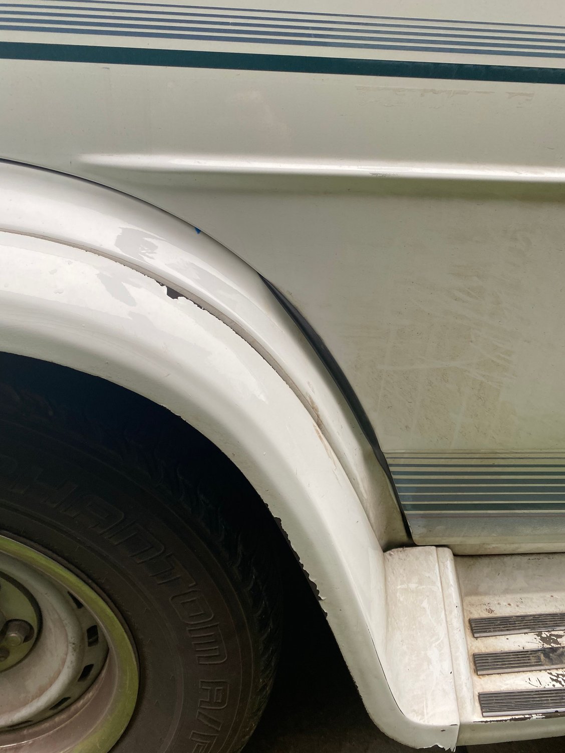

So we replaced the driver's side front door's weatherstripping last weekend and it seemed pretty good, although it did seem too thick/dense for the door compared to the old stuff that was on there. Fast forward to this week and I noticed that part of what was on the bottom section got pretty badly mangled somehow. It looks like the way that it is seated on the door, somehow it was getting caught between the door and the body (see photo below.)
Does anyone have a suggestion of how to fix this and/or how to keep it from happening moving forward? So far, we put some more weatherstripping adhesive under it and are leaving it to cure for 24 hours.

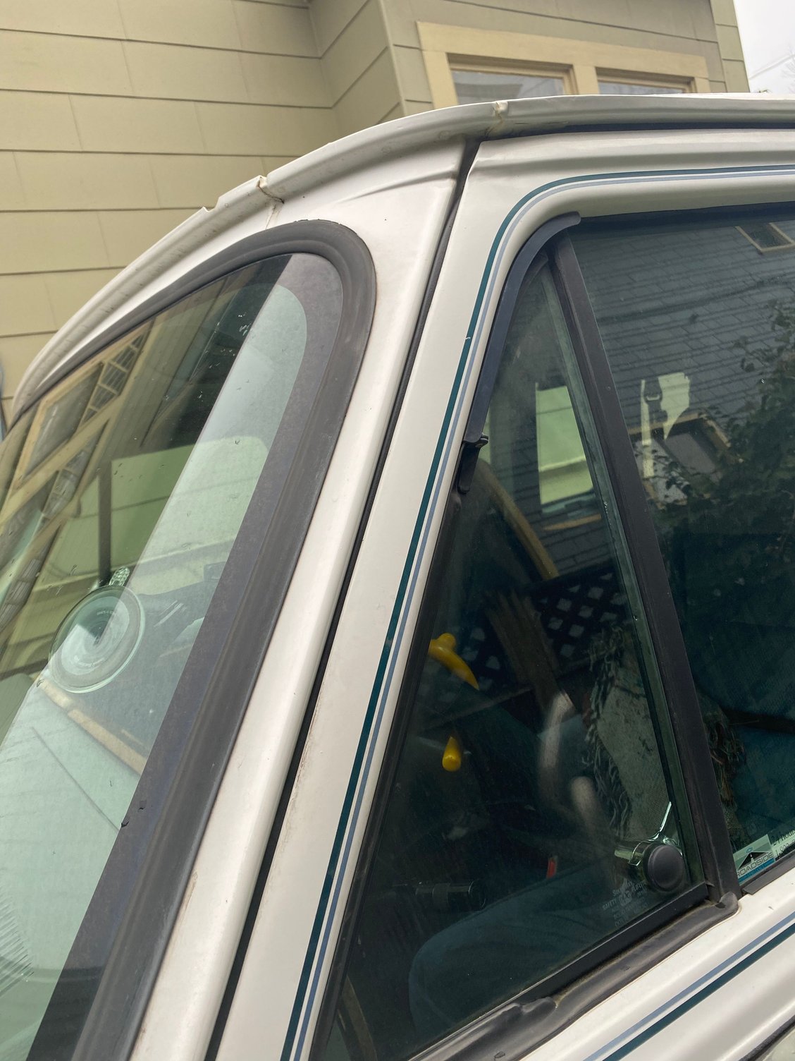

They seem to line up well enough, though I’m no expert and I do think the wear/patina on the body at the bottom here sounds like it may also be a symptom of what you’re talking about. I took some photos:
The striker
This is an exterior shot of where the new weatherstripping is bulging out between the door and the body.
I also noticed the new weatherstripping seems to bulge out here. It does the same thing in the same spots on the passenger side, where we haven’t replaced the weatherstripping yet.

Sometimes the hinge bushings will wear and allow the door to sag and lose a good seal. The bushings are available separately, but it can be a PITA to replace them,,,sometimes.!
Body shops come across these problems all the time and they will have a glass place do the glass repair if necessary to repair some serious leaks
Adjusting the door position will sometimes help depending on what is the problem.

Do you think that is what’s going on given the area where the weatherstripping is bulging on top as well though? (Third picture from my previous post.) It seems like if the door is sagging that there would be a gap in that area, right? 🤔
Although that worn/patina area when the bottom front door connects with the body has me thinking you may be right. I’m taking her in to replace and reseal the windshield next week and they’re supposed to do an all-over leak test (body too), so maybe that will help suss out the problem. I will say the new weatherstripping has vastly improved the leak, but if the hinges or bushings are bad, that will likely to continue to get worse over time, correct?
