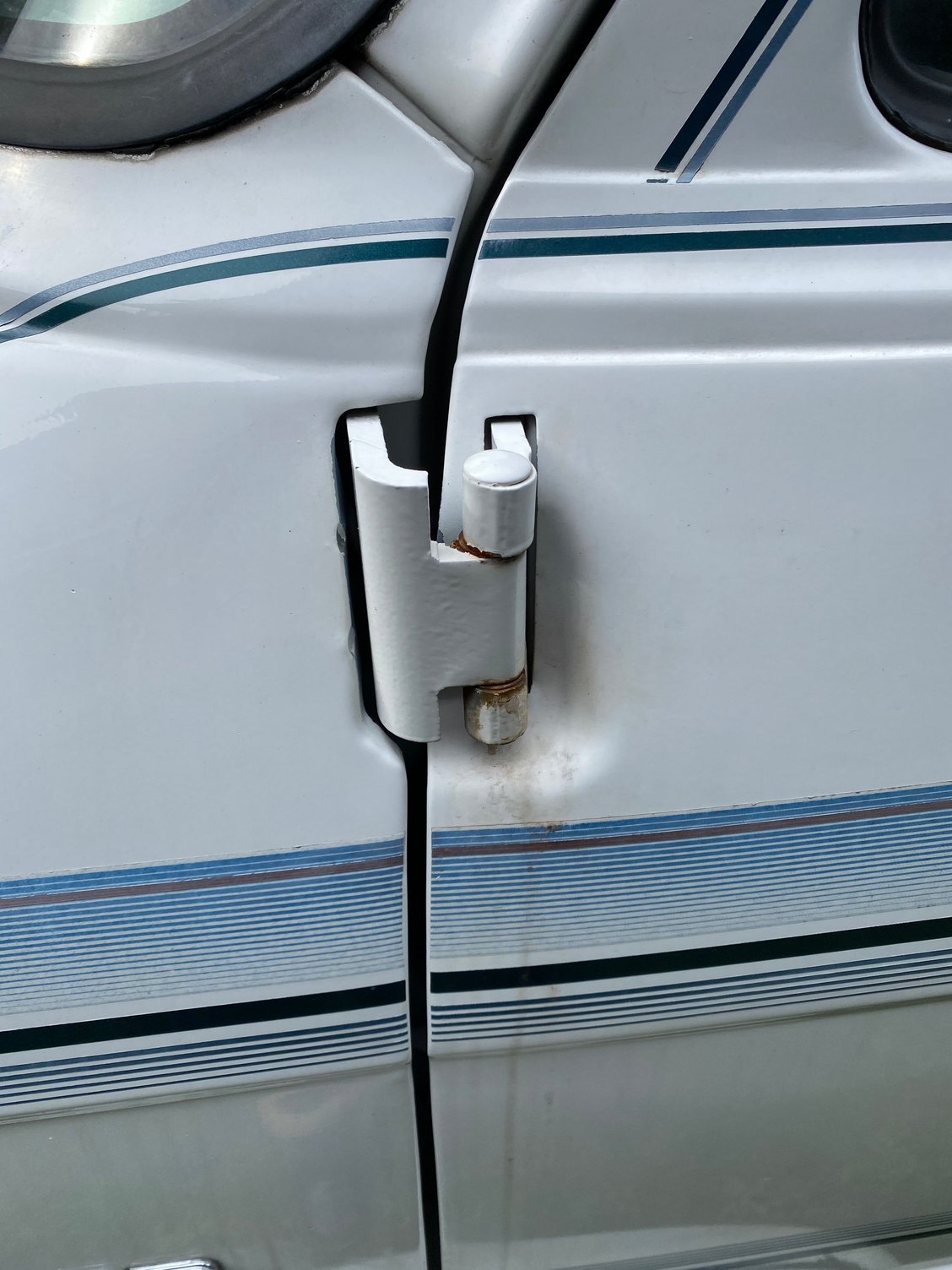

here are some photos of the hinges, maybe that rust is a sign of what you guys are thinking is the issue?
Driver’s side
Passenger side
Old Mar 8, 2021 | 9:26 PM
  #12
yeah the driver's side looks especially wallered out. Which makes sense.

Thanks for your feedback guys, guess I’ll have them tackle the windshield and see what they find for leaks and probably just replace all of those bushings before continuing to replace the weatherstripping.
