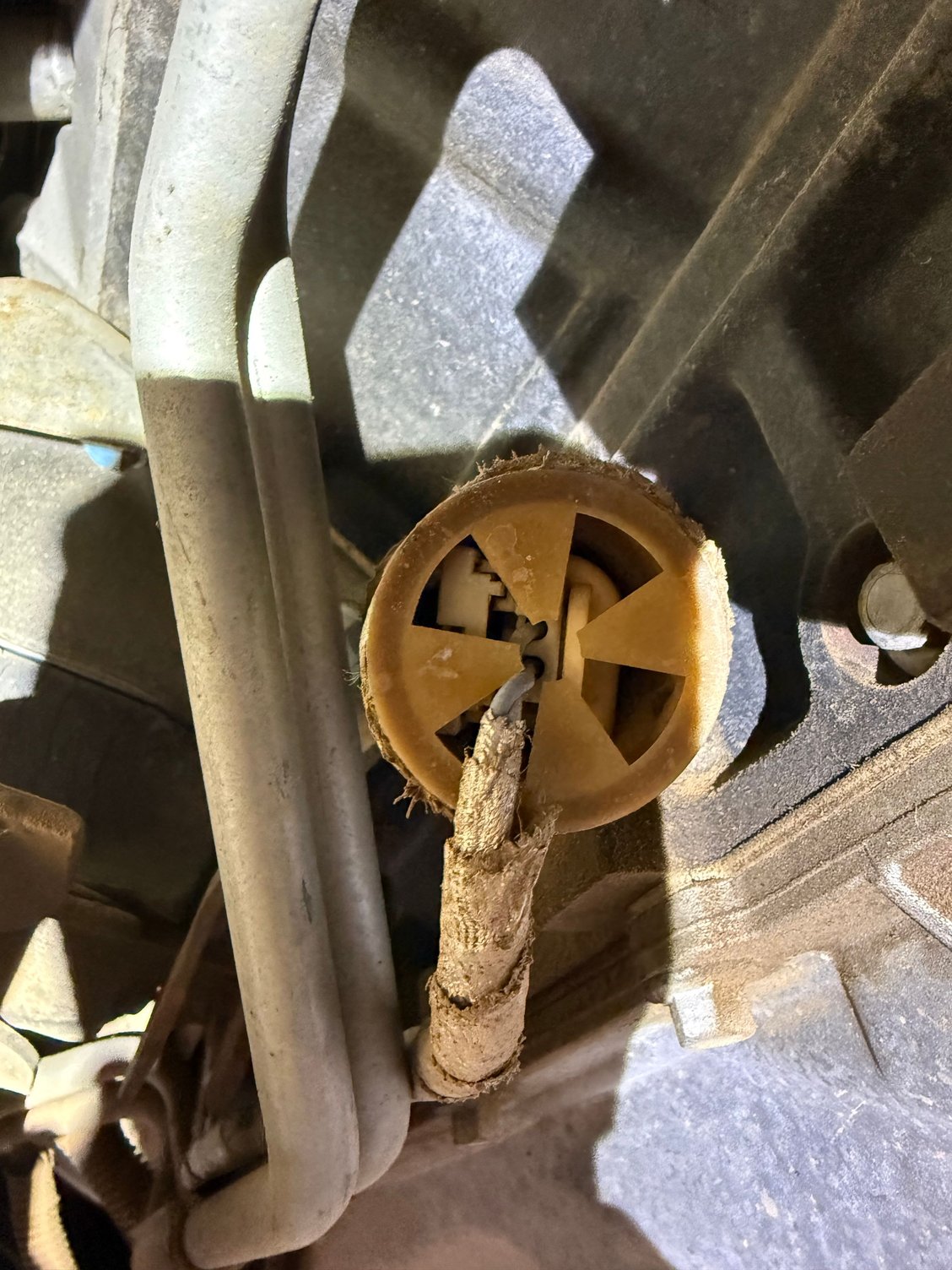

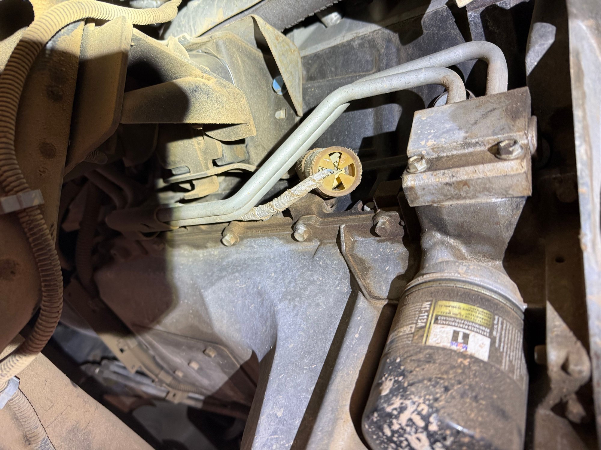

Miracle of miracles I think mine are down below on the block
can someone look at these pics and confirm
have these on both sides, one is in front of the starter , seems to match some videos showing where to change them....

That looks like this to me (as you say gen 4). Maybe charm had the wrong info for your year... Get what you pay for lol.
https://lemon-manuals.la/Chevrolet/2...l%20Procedure/

Just confirming on my 2008 express 3500 with 6.0 the knock sensors are below not under the intake on my van, hope that helps someone else
In those pictures are the covers for the knock sensors
