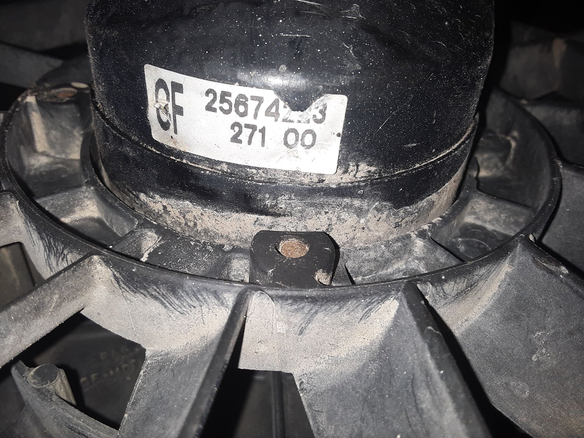

Hahaha. In the process now
Park ave fans

Ray, that is pretty much what I had in mind...are the parts from another GM product?
Gary
Old Apr 13, 2020 | 12:39 PM
ray caldwell's Avatar
Joined: Feb 2020
Posts: 136
Likes: 14
Gary

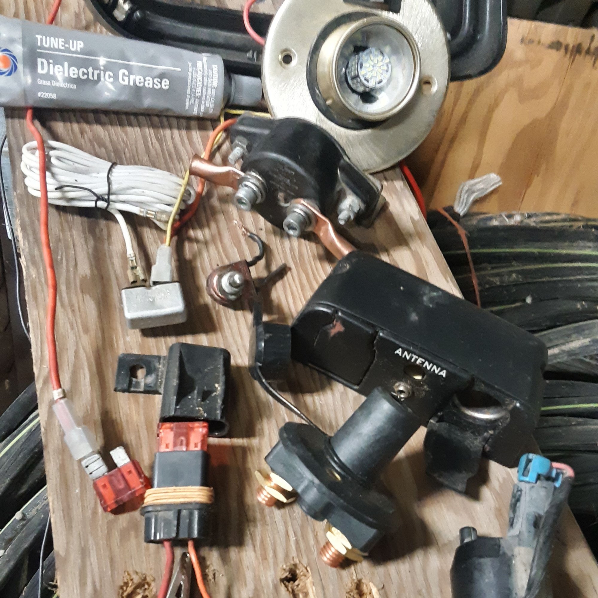

Looks like a 97 and up buick park Avenue. The pull an pay in Lubbock runs a wheelbarrow aale. All you can stuff in for $100. I looked at fans all day. Theae are better than Cadillac and Corvette units. Getting the 2 ralays an thermostat is up to you. Boshe sells new ones reasonably. Im putt a 327 in my van so i did not grab the whole harness just need the plug ends a strong switch. I get battery disconnects at harbor freight for $6

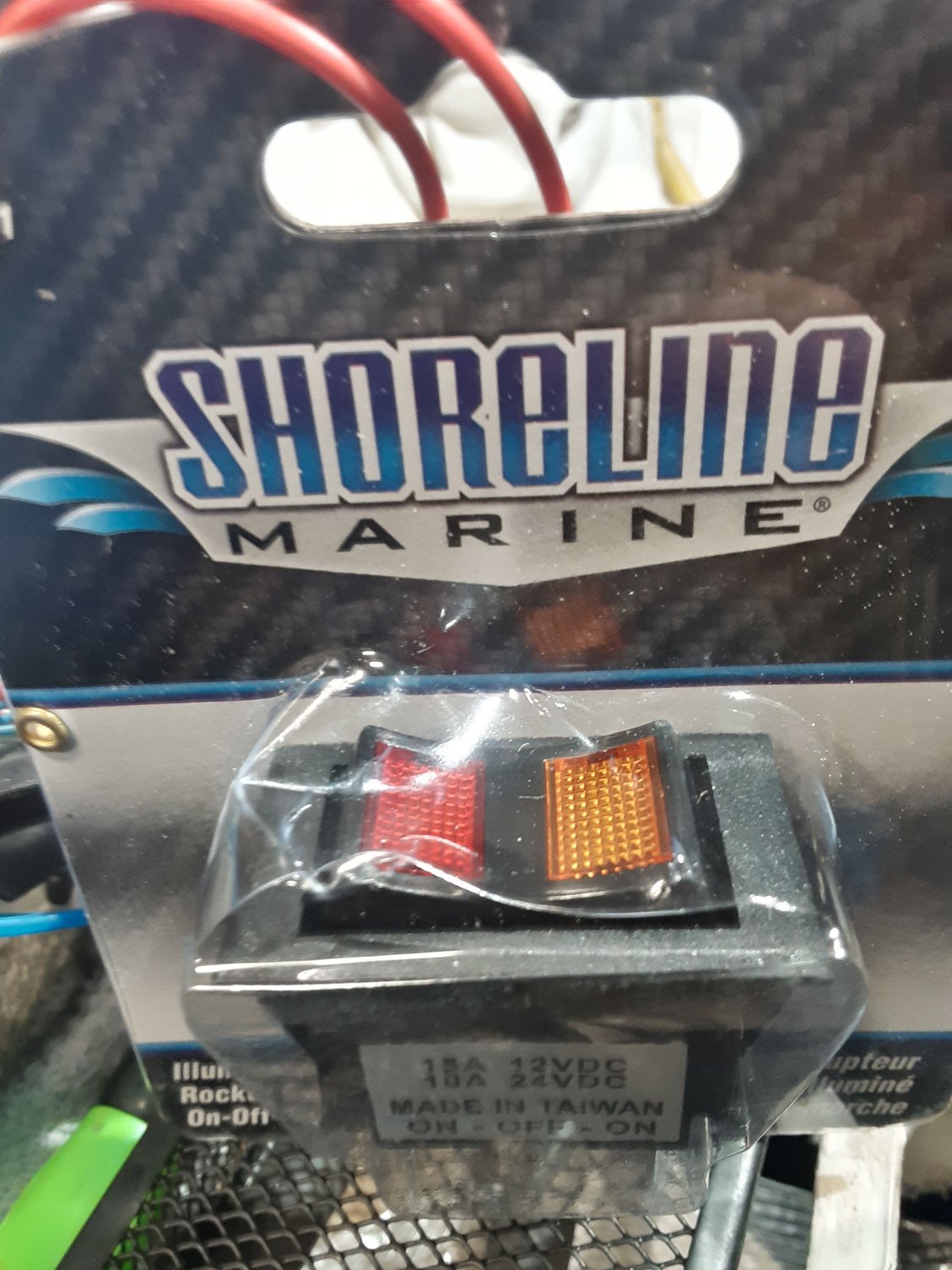

Just had then on a 20 amp switch for each fan temporarily. Will be putting van back together in a couple weeks after engine is in. Took me all frigging day to re-engineer a rotor button that came with ignition. Getting old i guess plus you cant have confidence just to bolt on parts and i tend to use industrial hardware or at least marine parts whenever I can..every splice in harness is soldered

I felt bad that I didn't have any numbers on this project. Sometimes I just eyeball things if I doesnt affect suspension geometry or dependability. So here I go without knowing what I'm doing
Some of the things from jy. Dont go just for a fan. You will have a rainy day in garage if the virus dont get ya. Try to find a yard wit a pice list and sign up for notifications for the deals. Best are in Colorado springs and Albuquerque. I gotta find some more around Chattanooga
List all electric parts you want also. I brought back 2 amps and a sony stereo for garage mood music. Make sure you get pigtails for fans!!! New 50 anp Bosch relays is new parts. But wire on up should be grabbed while there. I haven't bought new fuses in 5 years
The fans coincidentally wer the same width as the fan shroud in gvan-32 inches i cut the top half of shroud to just lip over radiator half inch and removed bottom half. Frame mounts were 26 in wide so i just used cable toes til now grab and split hose for edges on radiator side (front)
Relays tuck in anywhere. Test your wiring 1st
I got a 2 position marine switch. Red side will run both fans- amber only one. . May change my mind after i get oill and trans coolers in front. Will check back iff yall dont get something. Todays project is steerin stabilizer and test stand for engine. Oh... part # if you need it P
