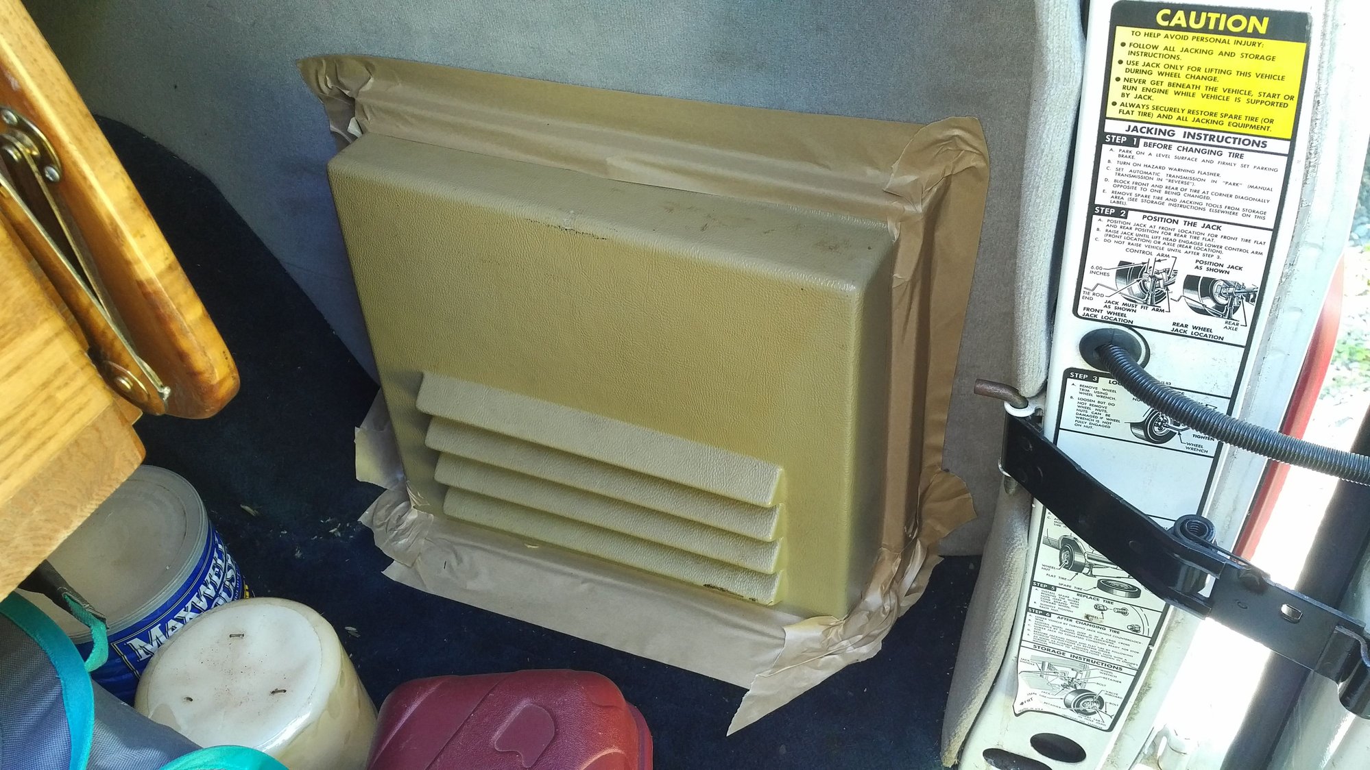

Here's some random pictures of the van and its rear AC so you can kinda get an idea of what's going on...
van
This is the old fan, but I don't think I remembered to take a picture of the newer one- it's supposed to succ the air through the filter and blow it upwards into the vents but it doesn't seem to achieve much
And there's the cover
and the vents!
And the whole thingy
The main controls
and the rear fan speed dial!

Is this what it looks like now if you take off the front cover? Do you still have the piece that was cut out and can you put it back on and duct tape it to make a seal.
If that is how it is now, then air is not being pulled across the coils. If you turn the system on and the coils get cold, try to fab up a cover and seal so air is forced through the coils and see what it gets you.

First thing: The main issue with my rear AC was not the rear AC itself, it was the rear HEAT.
Yes, the rear HEAT. These two lines bring engine coolant all the way back to the rear of the van:
I don't know why I never realized it! I had looked at it plenty of times, and yet it wasn't until this summer that I was rooting around back there and burnt my hand on one of these blasted hoses!
So those hoses bring in the heat, and THESE hoses bring in the AC:
I never knew that! Under the hood, there is a vacuum-operated heater shutoff valve, which in my case, had broken. It still worked, but it simply didn't "close" when it was in the "closed" position:
So, I bought another vacuum thingy on Amazon, installed it on the coolant line, and bam! No more rear heat fighting with my rear AC!
THAT was the problem. Air came into my AC unit, but the rear heat was simply overpowering the rear AC. Good thinking Mark III!
The Vacuum-coolant-thingy is set to "open" when you slide the HVAC slider to "heat" on the dashboard, for anyone else troubleshooting one of these.
