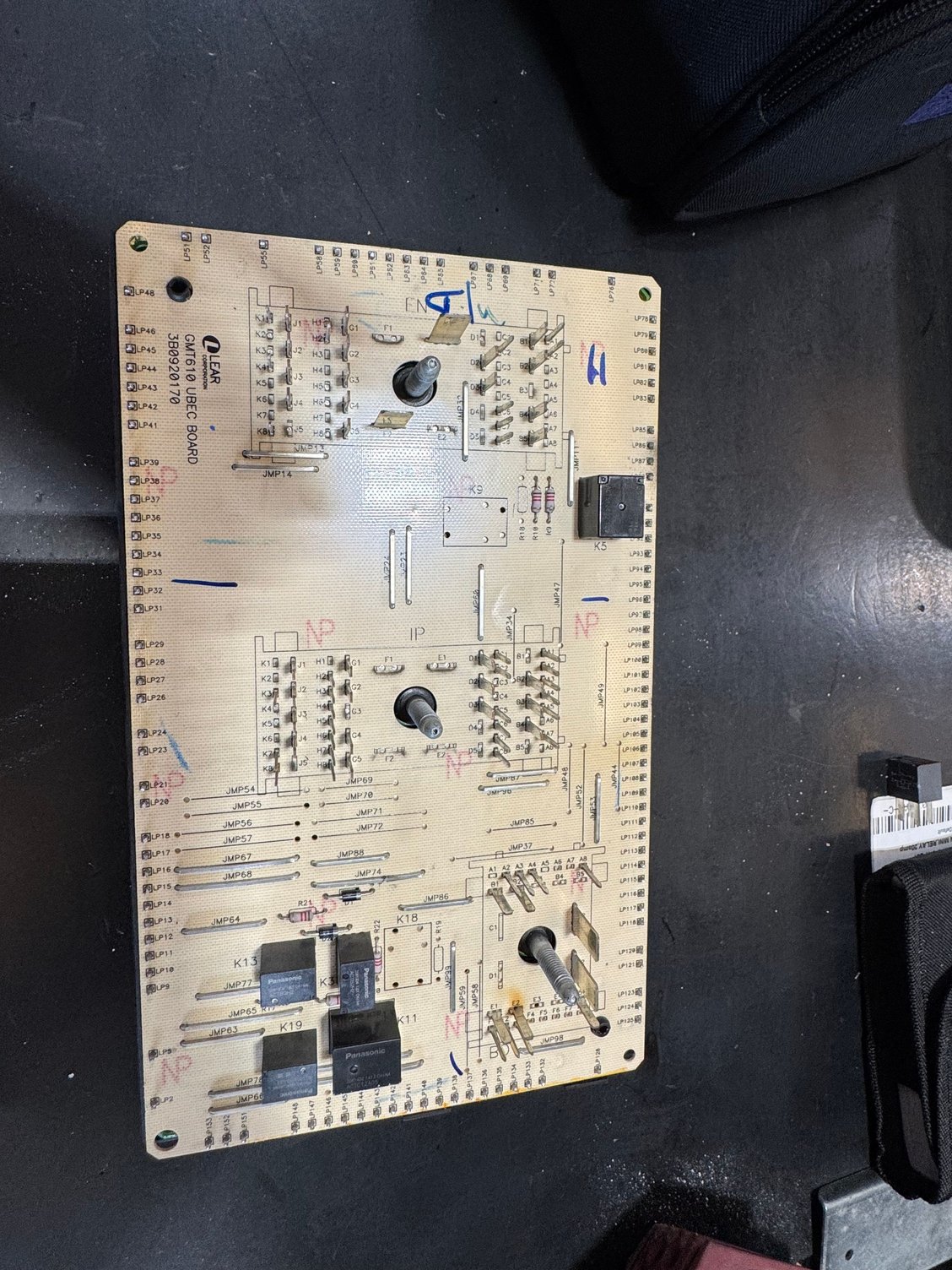

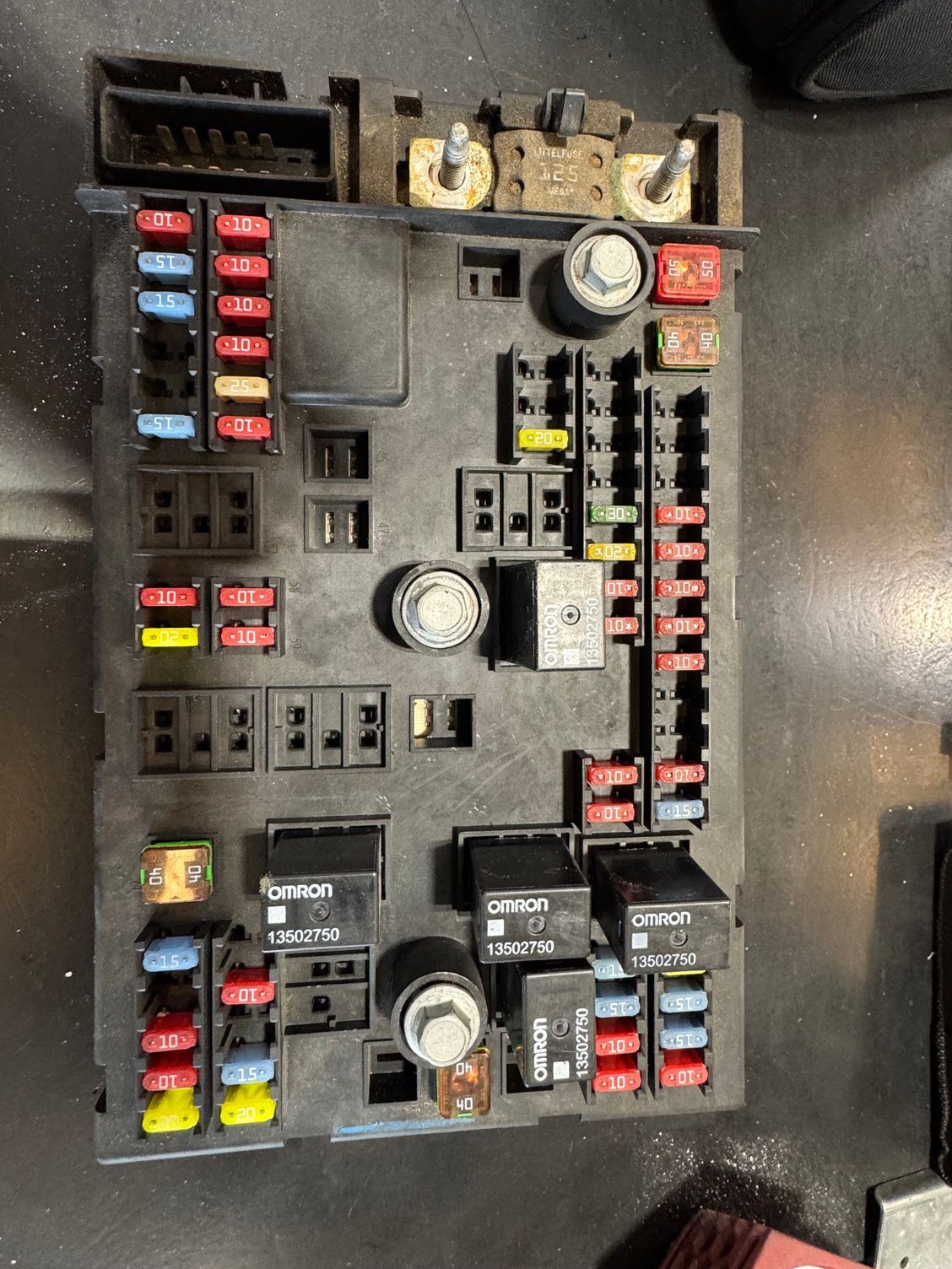

I’ve been working on 4500 Savannahs for 20 years, some of the newer models have a relay on the backside of the fuse block. On the inside of the fuse box lid it has relays not shown. That’s because they are built into the bottom side of the block. One is the stop light relay. They are soldered in, so you need to buy the fuse block. Around $150-200. They can’t be replaced. Must by the block. That will fix your brake light problems if you’ve exhausted all the mentioned in your list. Should be 2013-up.
Fuse block
Fuse block
Back side of block , soldered in relays. one is for brake lights k5 I believe.
