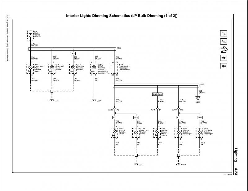

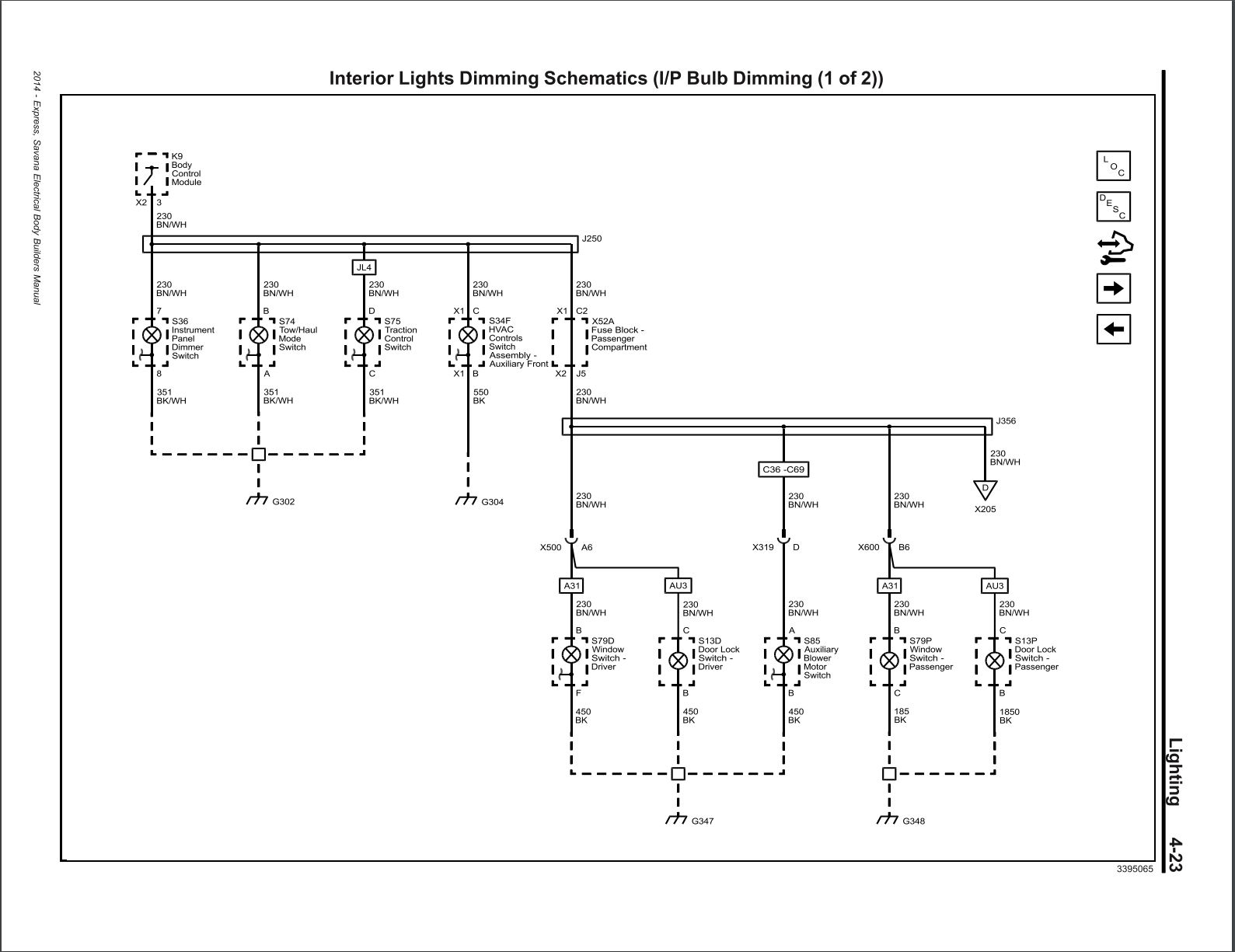

The BCM controls the lighting system through circuits that enable the exterior lamp functions of the park lamps, the head lamps, the fog lamps, and the interior lamps. The BCM opens these enabling circuits 10 minutes after the ignition switch is turned OFF with no lamp switch activity. If the ignition switch is turned to any position other than OFF, or if a lamp switch is activated during this time period, the timer resets for another 10 minutes.
Something triggers those lamps (highlighted in red) to stay on, or to never turn off.
OK. Some success.
If I disconnect the Rear Fuseblock from it's 12v Supply the lights go out. That helps narrow the problem. I don't think it's a Control Device powered via the Rear Fuse Block grounding the control circuit simply because pulling the BCM1 and the BCM2 Fuse still keeps the lights on. Furthermore, the LED's (the other IP's) are not lit. Therefore I have a backfeed on the circuit. Disconnecting connectors X205, X500, X600 and X318 does not solve the problem. It's either the Rear FuseBox itself or the Body Harness or something not fed through X318... have to think about this.
OK. More Success.
-Removing wire from pin C2 the x52a X1 Connector has the dash lights working properly. Now it's just my door lights staying on because there's a back feed somewhere. Getting closer.
Those lights on the PW and PDL are just LED right? Four LED's should use minimal power. I'm fine with this for now. What a major setback on life this has all been, trying to find this problem. However, I caused another one changing the battery and recharging so often. The Positive bolt built into the battery wire is stripped. I just can't win. It works, but it's definitely going to cause a problem at some point.
