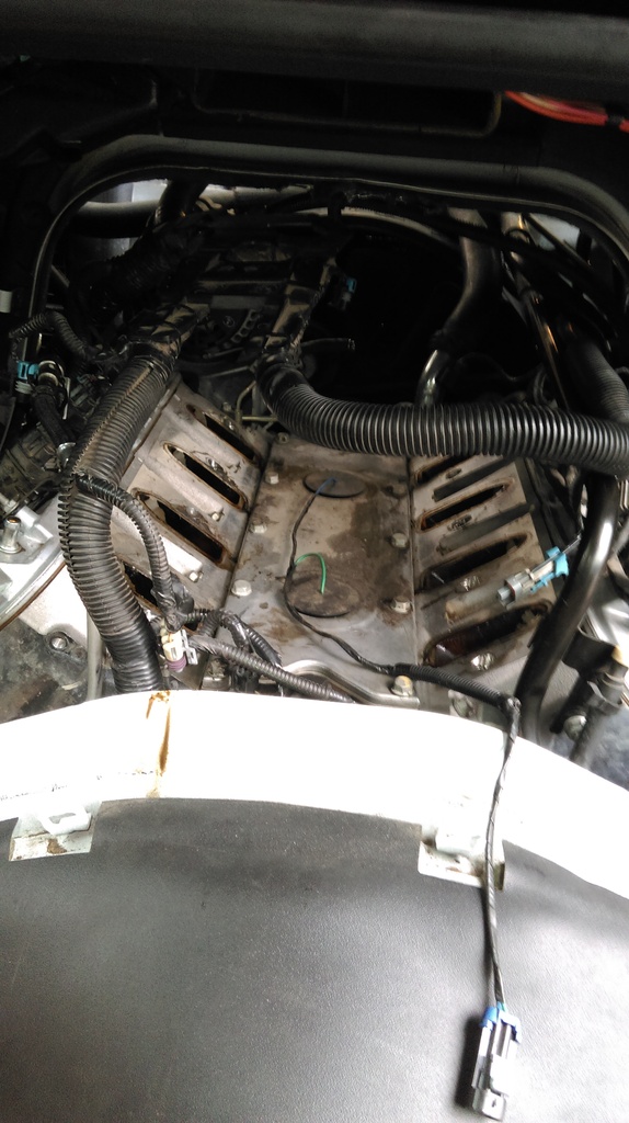

So I've been able to work on the van a bit over the last week. I also got paid for a machining job that allowed me to buy some goodies! In the mail are new shocks, new touchscreen stereo with backup camera, some sound damplifier and FLOWMASTER 50 Series mufflers! Woot! It's got a mini LS, might as well sound good
Before we get there, some maintenance had to be done. I needed to replace the knock sensors, so we did both sensors, sub harness, intake gaskets, throttle body gaskets, spark plugs and wires, and air filter. I also put silicone grease on all the connectors I could find.

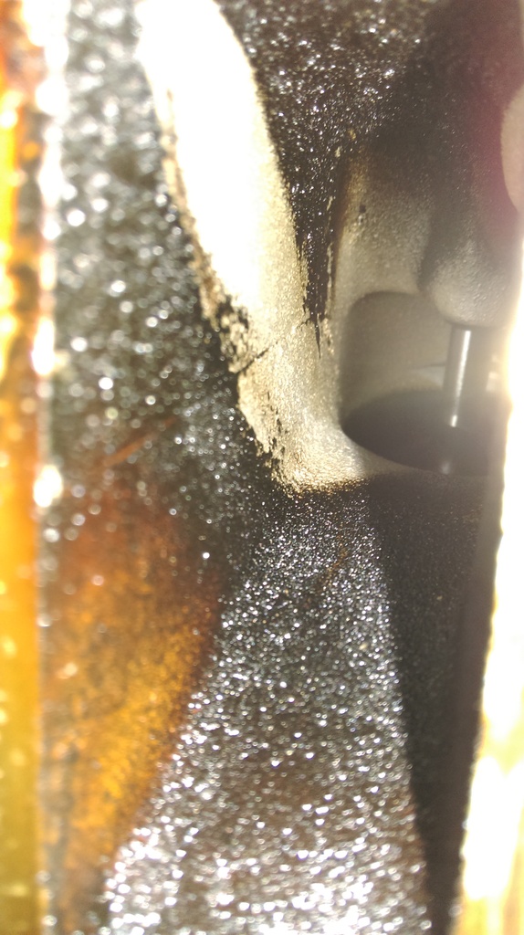

I thought the injector wash was pretty interesting. Also, VALVES!

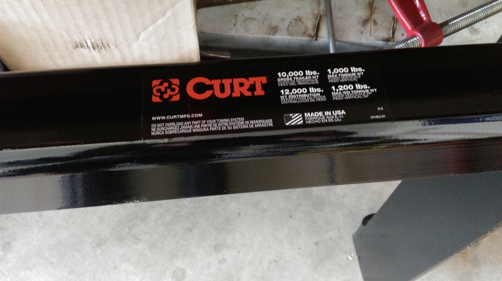

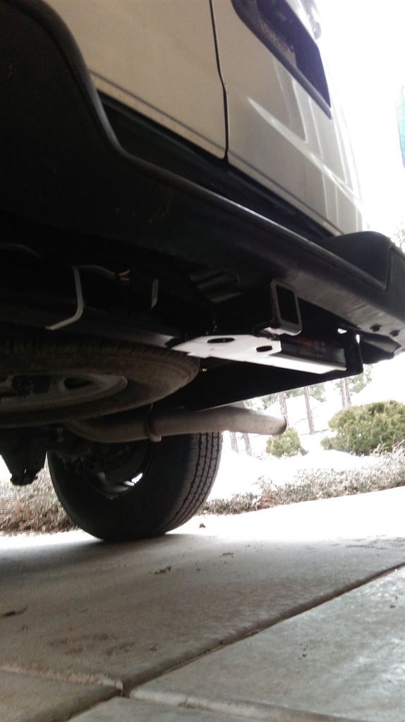

I installed a class IV hitch

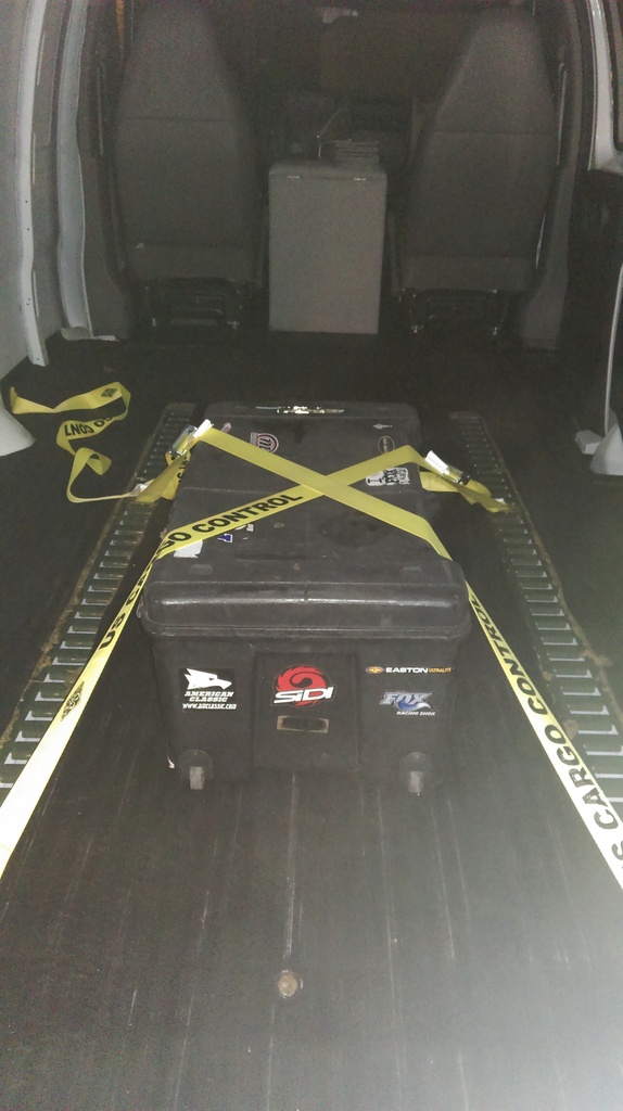

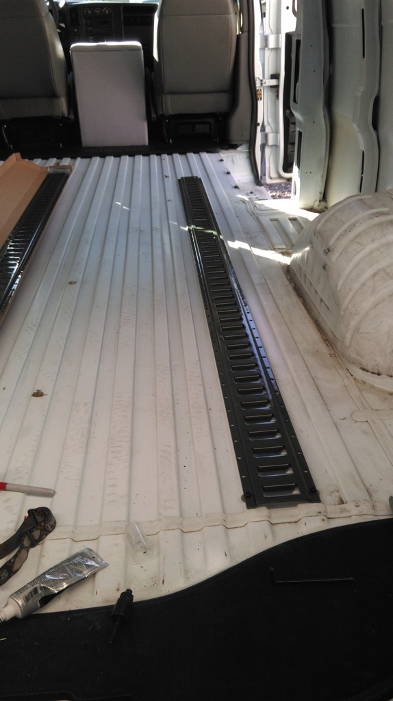

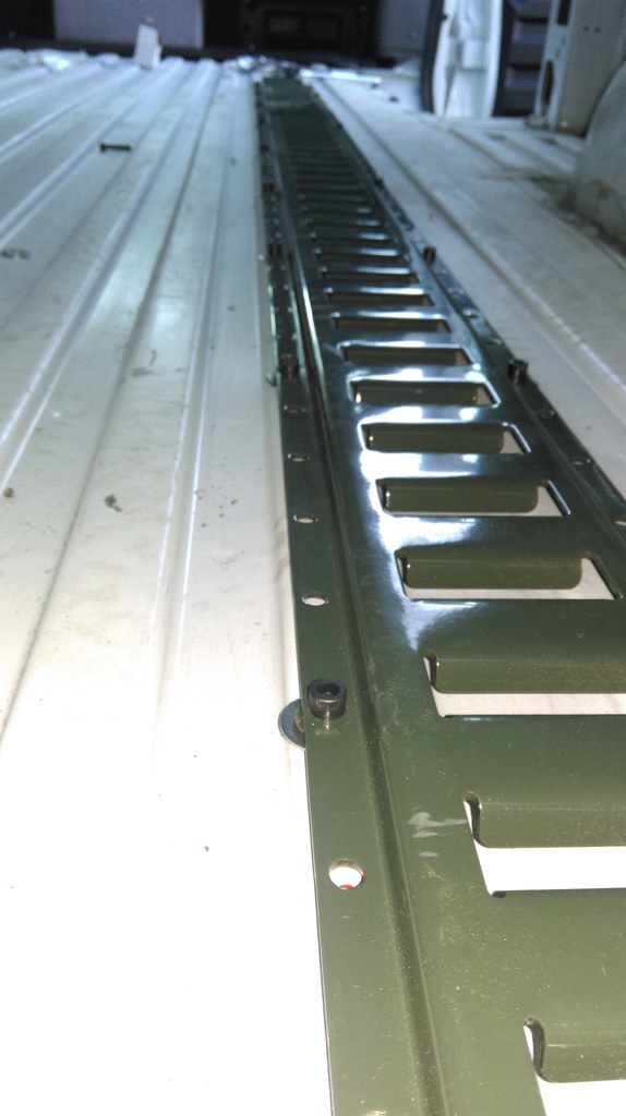

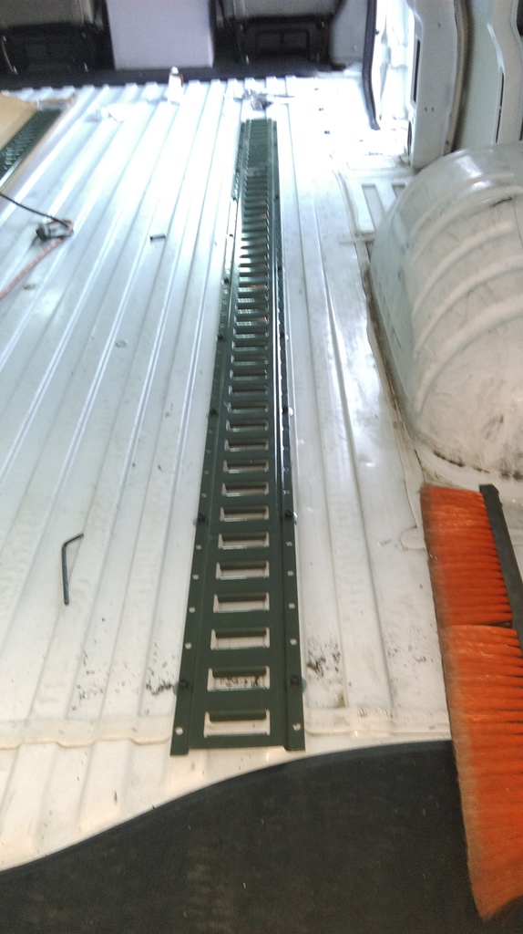

Then I started laying down the 8ft lengths of E-track I got on Friday.

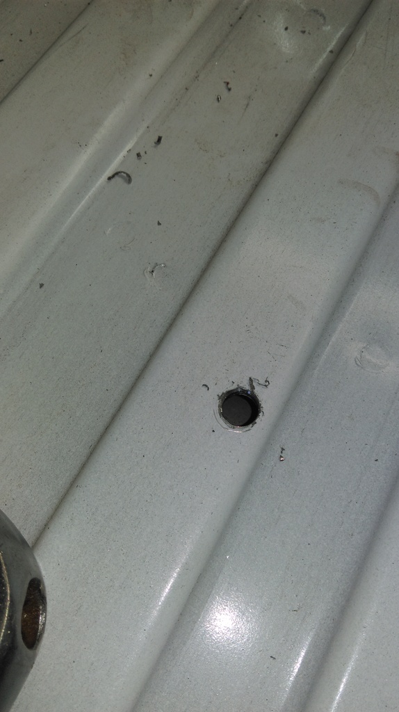

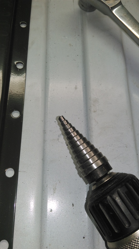

First, drill a hole
hole

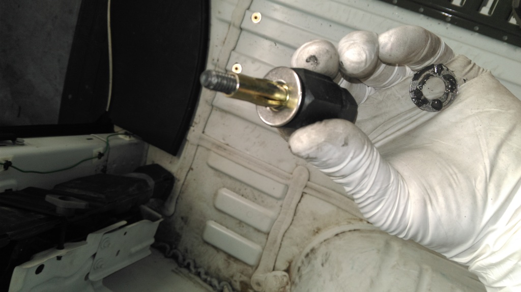

then, load your high strength rivnut onto the flaring tool

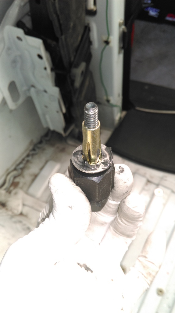

add a washer

and some rtv to seal/adhere

Then you put it in the hole and wrench the tool to expand the nut tightly around either side of the sheet metal. Whala! integral anchor point.
Repeat this 20 times per side while avoiding expensive bits underneath (this van has GOBS of room under the floor) and you can screw down the e track. You have a very strong and well distributed composite beam now.
you can also position it foreward and back with relative ease.

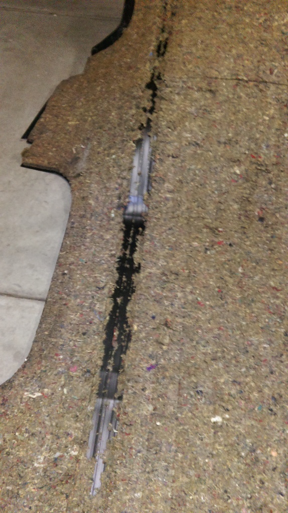

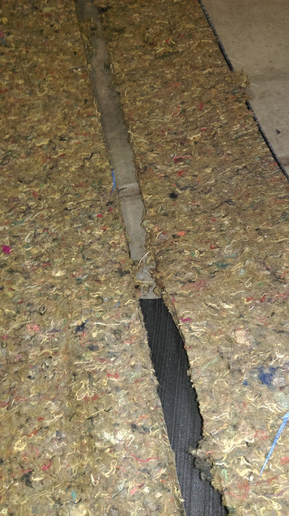

Cut some crap out of the floor pad which you'll probably throw away later in favor of bedliner...
Aaaand Bob's your uncle.
