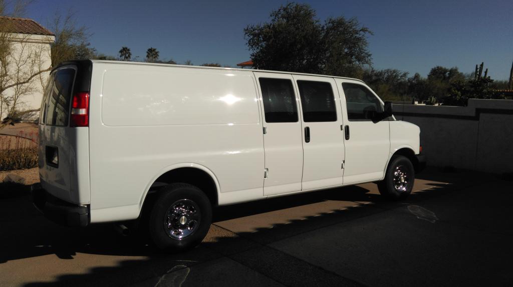

I just brought home this beaut to haul my toys around
She's an '07 2500 extended cargo with the 4.8 (bably LS), 4l80e trans and a dana 60 rear axle. Sadly, no AWD, so a few days each winter will be interesting...

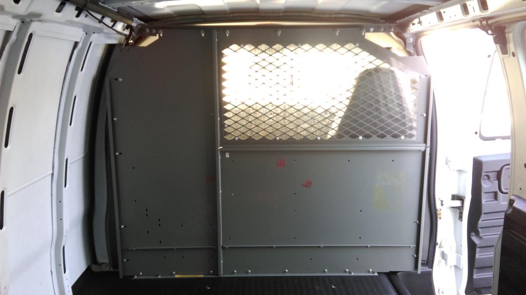

It came basically empty save for this obnoxious, rattly partition (anyone want to buy a like new partition?)
tan vinyl interior, good for cleaning grease off of. The driver's seat wasn't collapsed or torn, and I was surprised how clean the van was overall.

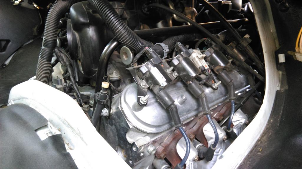

Of course the knock sensors threw a code not 10 miles from the dealer lot...
So I pulled the engine cover to see how hard it would be to do myself or it I was going to invoke the meager powertrain warranty I have on the van. Long story short, I don't really trust anyone else to not cut corners so I ordered parts to do it myself. I'll change spark plugs and wires while it's apart and then hopefully not touch it for a LOOONG time.

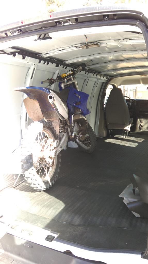

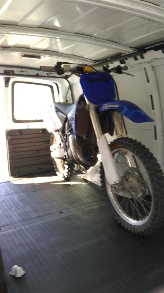

Here's the intended use: hauling bikes and keeping them away from prying eyes.

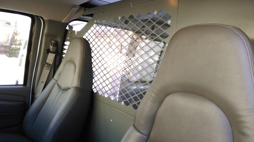

Decently roomy, but it's no high top. I didn't want the extra 'sail effect' in the strong sidewinds we can get here.

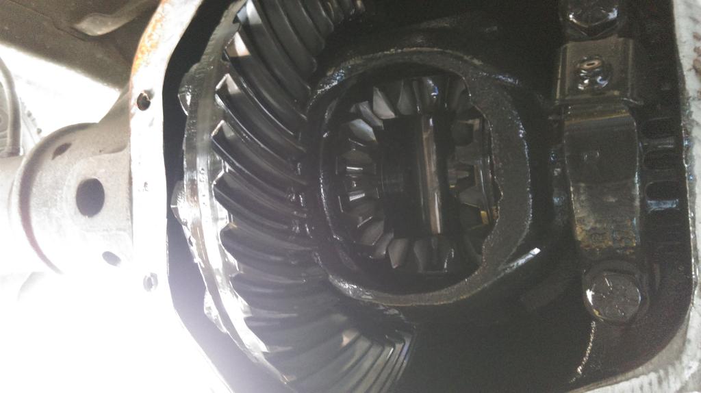

Dana 60 rear end with 3.73 gears. I'll be putting in a posi to help in the snow before this winter. Looks like it should be easy, those appear to be screw carrier adjusters! (I've done conventional diffs before where you need a case spreader and all than jazz, and it SUCKS)

Good looking van. I like the wheels. You may want to keep that partition, will protect you, in case of an accident, from cargo.

Nope. Nope. Nope. Nope.
I want access to the rear seat (when it's installed). also, it's rattly and I will have a near silent van when I'm done.
Cargo will be tied down better than many commercial vehicles.

If I was you I'd get plywood or 1x4's mounted to those walls pronto. One slip of those bikes and you'll have a nasty dent on the outside.
I'm glad I bought a 135" for the turning, parking, etc., but everytime I see an extended I regret not getting one.
