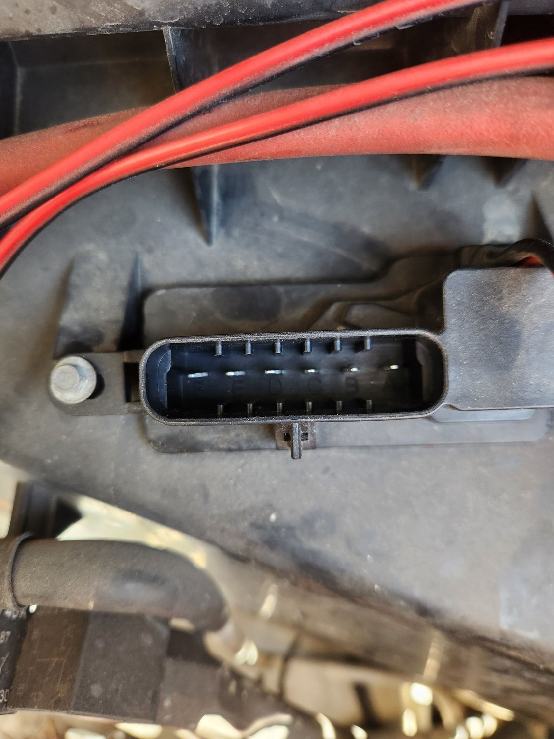

The harness looks worse this time around. Though the resistor looks fine.
Old Jul 31, 2024 | 6:47 PM
Gumby22's Avatar
Joined: May 2011
Posts: 1,578
Likes: 302
From: Central Iowa
That’s not nearly the worst I’ve seen.
The resistor does look OK but did you check the connection at the blower motor as well? They can have the same problem.
Here’s what you need - Resistor Pigtail - this comes with heat shrink connectors but I recommend soldering if you can.

Yeah, I was planning on soldering them.
Connection at the blower is not damaged. Though the Dorman resistor doesn't exactly fit great and doesn't have a satisfying click, but there is no evidence of overheating, arcing or a bad connection there.
I found a new dorman resistor + pigtail for $20 on amazon, might just get both.
I also discovered I mixed up the fuses. I had the swapped a 10A and a 20A fuse, so the HVAC was supposed to have a 20A fuse, but had a 10A. Kind of surprised the fuses lasted as long as they did.
Either way, the harness will be replaced, but thinking I can skip replacing the blower for now.
