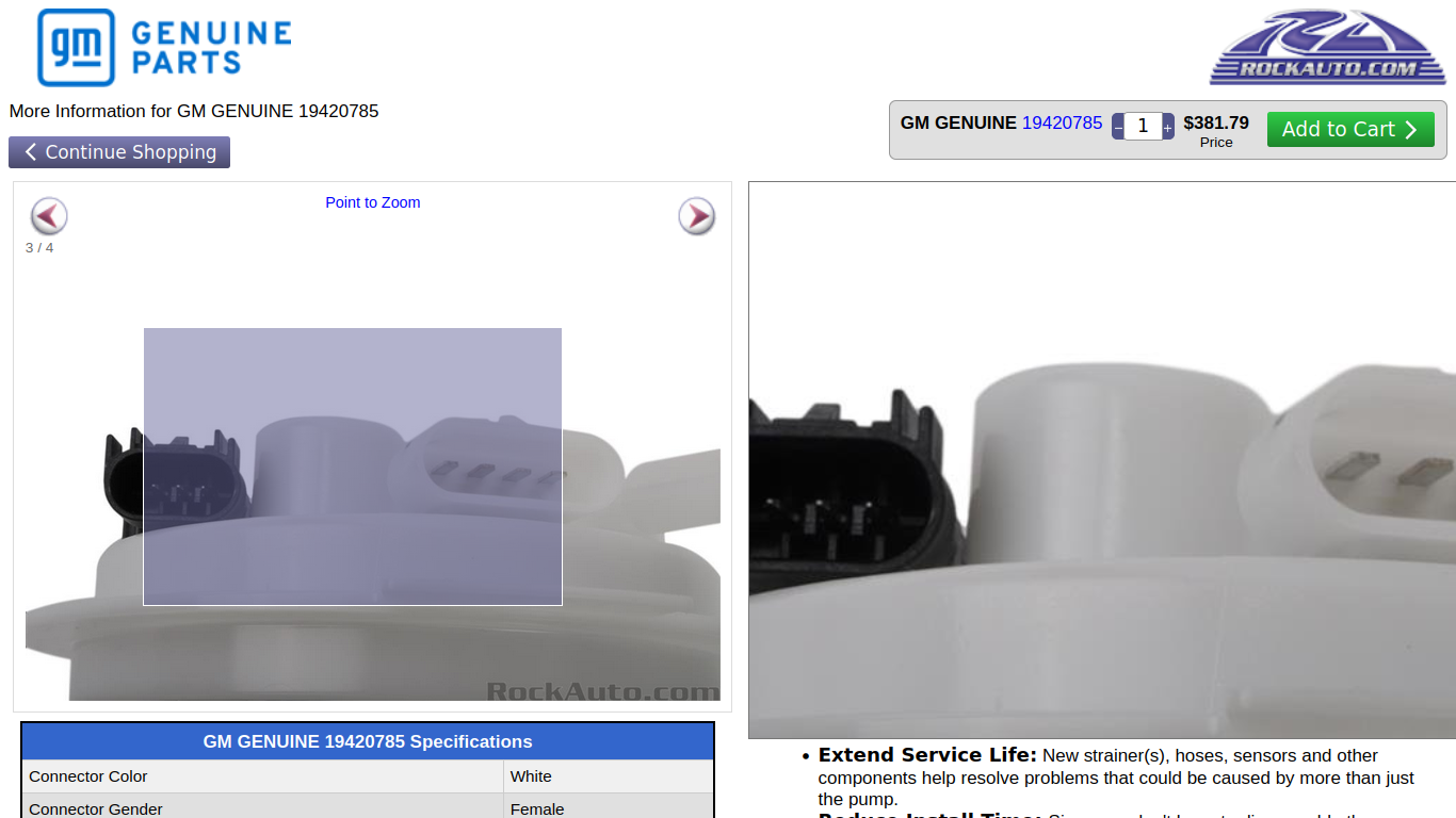

OK I figured out where the Fuel smell is coming from ! FINALLY! I used the borrowed creeper I have (aka THE LAND YACHT) and getting the worlds best AB workout I was able to stick my neck, honestly get one eye ball up there on the fuel pump. There are two places where I was able to squeeze my small head in between the exhaust and diff on the chevy express. One is further towards the rear wheels in between the at the end of the cat and in between the diff. I stuck my head up there and could see the fuel pump assy. I was hanging onto the diff like a monkey with my hands to relieve some of the pressure on my neck. I stuck my hand all over the pump feeling from leaks on that side and NADA. SO I went to the OTHERSIDE of the fuel tank where the filler neck is. I was able just to get one eye ball on the fuel pump from that side and ... I noticed wetness on the plastic part. This is the plastic part guys... Derrick... Triage...
It;s that round peice in between the connectors that is wet. I stuck my finger in there just barley and pulled it out. I smelled and it smelled like fuel. So that's the leak. Now it all makes sense because I was able to smell fuel on the same level as the fuel pump. Meaning the fumes kind of float around on top of the tank because fuel fumes are heavier than air. They kind of stay up there but when I smell fumes It's on the same plain as the fuel pump because the fumes hang out there.
so I guess what I want to know to is how the heck does that little plastic piece get broken? I can tell the van has taken an impact on the frame near the pump, but the fuel tank itself has no damage to it. I also know that the van sat for a quite a long time... could this just be corrosion as the fuel tank is suppose to be emptied in order to store it long term? or perhaps the fuel tank was siphoned because i am pretty damn sure the cats were stolen off it when it was sitting at the used dealership, so it would only make sense the thieves could've possibly damaged the fuel tank siphoning or attempting to...
I want to know these things because I still have the intermittent issue with refueling, where refueling get's difficult to do from time to time. the pump clicks off. My best guess is that something small has snapped off in there and is getting moved around. When the snapped thing is in the wrong position the tank becomes difficult to fill. When it moves around the tank becomes easy to fill again. OR perhaps the leak at the top is creating some kind of weird vaccum on the system, causin g a difficult fill situation? But why wouldn't this happen all the time then, and not just some of the time? Maybe a check ball or valve is to blame, perhaps these two issues are separate the fuel leak and the difficult fill situation, or damage from a big impact in that are knocked some stuff out of whack. could an impact to the frame right there near the fuel tank do that?

another picture here of the top of the fuel pump. I can't see it so I sure hope it uploads.

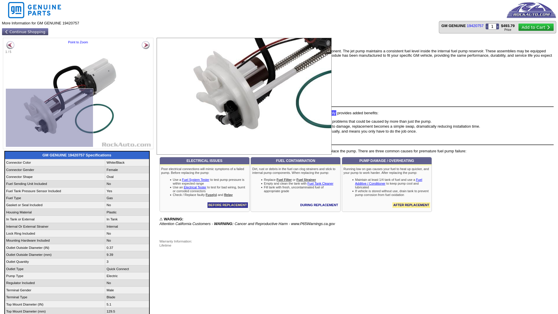

Which fuel pump do I need? the one with the sender unit?
https://www.rockauto.com/en/moreinfo...=10147&jsn=684
< Part image 19420767 Info
3 door; Base Model; LH Side Rear Hinged Door (E26)
$284.79
OR
GM GENUINE 19420785 Fuel Tank Pressure Sensor Included: YES Info One of our most popular parts
3 door; Base Model; Includes Level Sensor; Exc. LH Side Rear Hinged Door (E26)
